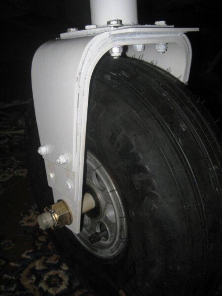

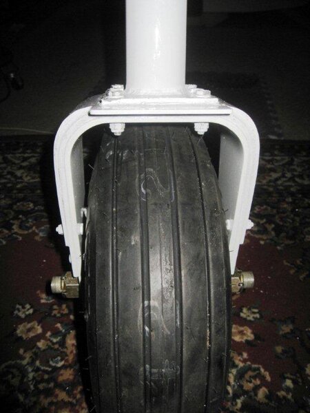

geoffreywh Posted April 20, 2010 Share Posted April 20, 2010 The picture of the welding on the front leg support is shocking. Bloody amateurish work. You cannot trust ANY weld on the whole aircraft, all will need grinding off and re-welding. Lots of luck......By the way ....is this aircraft of the type that has been grounded in the U.S. ??? Link to comment Share on other sites More sharing options...
Guest ozzie Posted April 20, 2010 Share Posted April 20, 2010 right about that nose gear weld. is that a factory job? i'd bore out the fork and drop the tube into it then weld it, much stronger than a straight butt weld. ozzie Link to comment Share on other sites More sharing options...
Adrian Lewer Posted April 21, 2010 Author Share Posted April 21, 2010 Your right about the welds, I have not welded since I was 17 and actual tacked the nose back on for transport, done a better job than whoever did it. Wait untill you see the engine mount you will laugh somthing chronic. The zenith CH 601 XL was the model grounded in the U.S as they had suspected weak points in the wing. Mine is the CH 601 HD and as far as I know there have not been any failures of any kind that where design faults EXCEPT the nose gear does have a habbit of breaking off so I will be modifing it with the XL nose gear which rectified this problem. Link to comment Share on other sites More sharing options...
Relfy Posted April 21, 2010 Share Posted April 21, 2010 Good work Adrian, keep the pics coming. It sounds like there are a lot of people interested in following your project with some great advice to offer. Some of the advice may be blunt, but it's all about keeping you safe big fella. :thumb_up: Link to comment Share on other sites More sharing options...
Thruster87 Posted April 21, 2010 Share Posted April 21, 2010 right about that nose gear weld. is that a factory job? i'd bore out the fork and drop the tube into it then weld it, much stronger than a straight butt weld. ozzie The current 601xl nose wheel butt weld from the factory is so strong that the tube will bend before the weld gives way.Know this due to testing one.The fork [2 x 3/16" 6061 T6]could be a bit stronger [say a solid 1/2"]so it would take side loadings better Cheers T87 Link to comment Share on other sites More sharing options...
