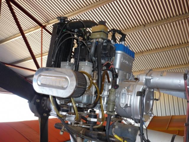

pudestcon Posted May 30, 2010 Author Posted May 30, 2010 Thanks David, I'll check it out. I wondered if you would surface on this one Maj;) It's a Rotax 582 blue head with a split (2 separate tanks) radiator. This is the engine here. Pud
