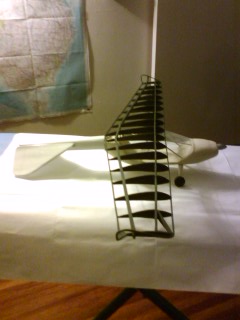

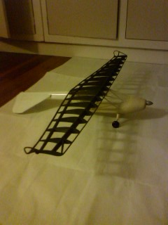

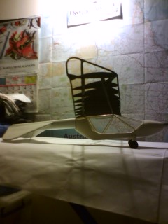

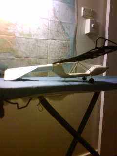

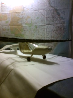

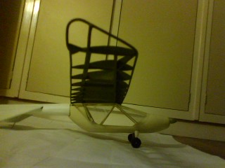

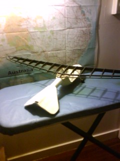

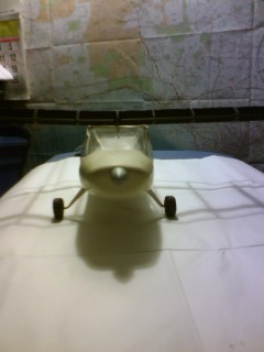

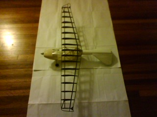

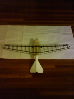

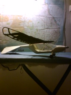

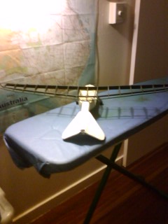

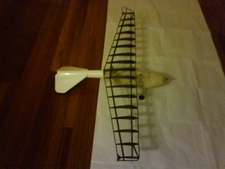

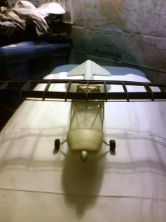

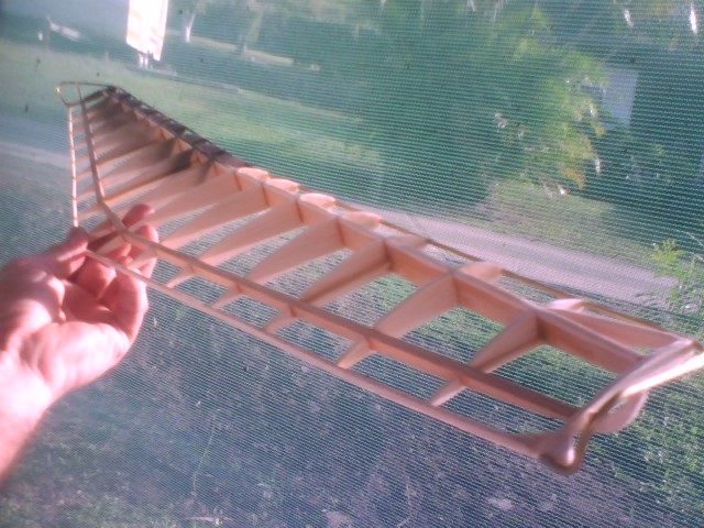

New photos of the model, wing to be covered soon and struts attached. This model when completed will be statically balanced and used for hand launched glide testing. I am very happy with the wing, it is relativly shorter than the Lazair (lazair-36 Ft...Mine around 30 ft span) and looks like it should be capable of the targeted 100Kts +, but should also be suitable for short field operations with flaps.
It won't be one piece like in the model photos, but two separate wing panels attached to the center section similiar to the Lightwing. Side cockpit perspex may also be altered for a more streamlined look. Foward nose entry is just about right, and visability from the cockpit, particulary foward and out the sides will be unmatched, except in a Drifter. The eighth photo is my favorite, and shows the true style of the design....Maj...024_cool.gif.7a88a3168ebd868f5549631161e2b369.gif All comments welcome !!

Nice Maj,
It looks a little like a parasol in a couple of the photos.
I'm sorry but the tail feathers don't look right without a vertical fin:sad:
I do like the overall look though, especially the use of see through doors and other cockpit panels - very nice.
Pud
Guest Maj Millard
Pud, Yes we are so accustomed to having some type of vertical fin surface. The inverted V does fly great, much better than the Upright V. There is plenty of vertical fin surface there, but it is not vertical...it's at around 45 deg. The air doesn't see angle, it just sees surface. When the wings are banked the tail surface becomes more banked and well more vertical. I firmly believe that we would have a lot more inverted V tailed aircraft if it wasn't for the tailwheel thing, which is a bit of a challange design-wise. A recent check on the Lazair website shows that many Lazair owners have done the conversion to a nose wheel. I did fly one of these once, and it was much easier to taxi on the ground with nosewheel steering etc...but no easier to land, in fact maybe a bit harder.
The Lazair Mk2 that Dale Kramer flew during his tour of California in 1982 was well capable of aerobatics as he demonstrated on occasions with smoke flares on his wingtips. I know he did loops and rolls but I don't recall anything more aggressive. He now owns and flys one on floats, and that video is posted on this forum somewhere.
When I flew Lazairs in the past the only difference I could feel was that the rudder pedal force was much lighter. The rudder still worked in the same manner, but the force was lighter. There was still plenty of authority. The inverted V didn't seem to 'hunt' like the upright V either. Anybody who has flown a Bonanza for instance will agree that they can waggle their tail quite noticably at times, especially at speed or in crosswinds.
I also feel that the inverted V just flys better in turns, and also reacts well in ground effect IE: lifts it's tail almost the instance power is applied, and seems to float down on landing which will make for a softer touchdown of the tail wheel. At real low speed on rollout for instance you might loose authority (bit like the Storch) but I do plan on having differental brakes on the main wheels which is the way to get around that.................Thanks for your input......................Maj...024_cool.gif.7a88a3168ebd868f5549631161e2b369.gif
