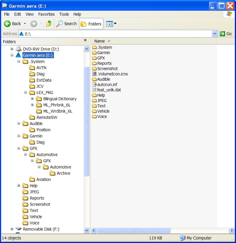

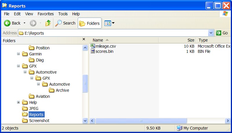

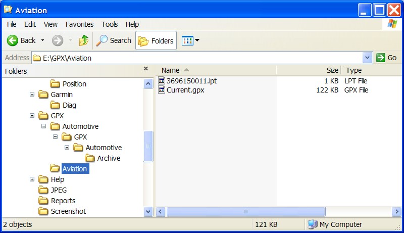

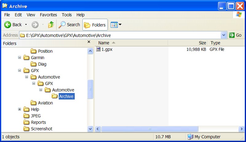

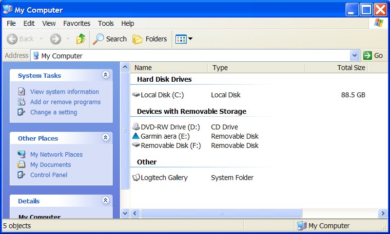

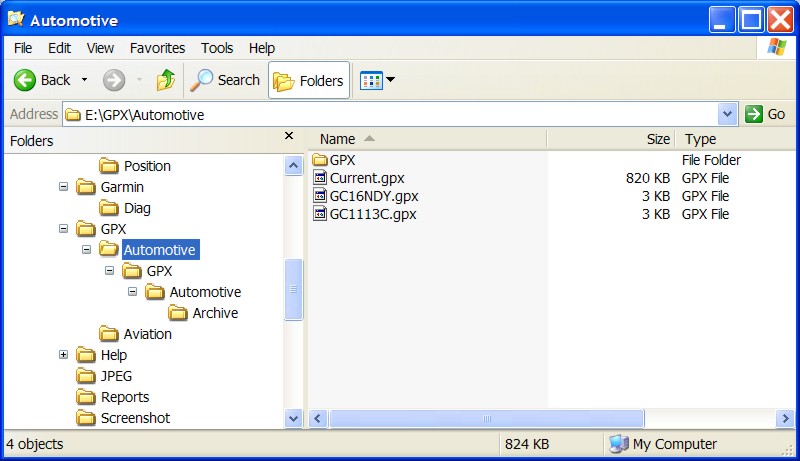

Aera 550 Filesystem
The PC is running Microsoft WindowsXP-Pro SP-3 and is up-to-date with patches.
The two removable disks that appear in Windows Explorer when the GPS is plugged in to the PC using USB can be seen in the first screenshot.
The remaining screen shots show the expanded filesystem tree on the "Garmin" Drive.
The "current.gpx" file in the GPX\Automotive directory contains automotive waypoints inserted through the GPS or using the web application at Geocaching - The Official Global GPS Cache Hunt Site, while the other two gpx files are ones I downloaded from http://www.geocaching.comand dropped there using Windows Explorer. These latter files contain one waypoint each.
If you add a waypoint file and then edit it using the GPS, the individual file will be deleted and the waypoint moved into "current.gpx"
The 1.gpx in E:\GPX\Automotive\GPX\Automotive\Archive is the automotive track log stored in a human readable XML file.
"Current.gpx" appears to be the user waypoints entered programmatically and a track log in an XML file. Presumably something triggers archiving the track log into files in the Archive directory.
I haven't played with this in aviation mode yet.
Downloaded GeoCaching Waypoint File in XML

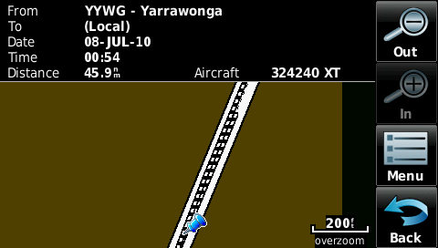

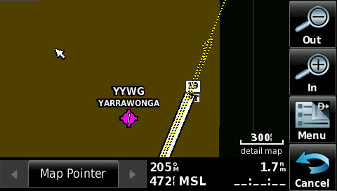

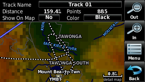

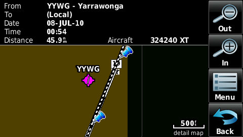

Garmin Aera 550 Air Switch
After today's cogitation and tonight's flight I am beginning to conclude that it is not just one simple on / off function.
This evening, I selected the "Numbers" screen before taxiing and then watched the Flight Time counter from line-up till it started counting. First I checked that it did not start when I was just gathering speed, and I purposely kept the engine revs lower than normal to make the take-off roll longer. Even when I hit rotate speed (55kn), It still read the total of the previous flight and continued to do so until I reached 380' AGL (800' MSL) at which it reset and started counting up air time.
At landing, the flight timer continued to count up until I slowed to approximately 20kt (IAS), when it stopped.

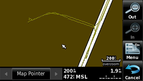

On the other hand the Flight Log, while it shows the same flight time, the flight track commences and ends on the runway. It is difficult to tell which marker is the beginning and which is the end, as they are not exactly co-incident with the start and end of the depicted track in the Flight Log.
In the Track Log, there is no start and end marker, but you can see both ends of the track. Again it is not obvious which is which.
It seems that to tell them apart, the flight will have to be started and ended on different runways.
When looking at the track on the Map Panel, you can see the full track starting from when the GPS was powered up, through taxi, backtracking, takeoff, landing, back tracking and taxiing.
The attached images show the AD portion of today's flight and a portion of an older Track Log from a nav to Mount Beauty (Note that the track log does not show that I landed, had morning tea and then flew out again This demonstrates a clear distinction between Flight Log and Track Log functions).
