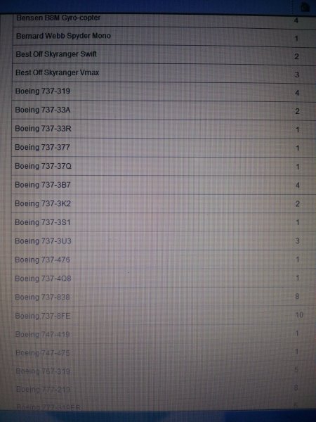

You may or may not be aware that, in New Zealand, every aircraft goes on the same register. There is no separate 19-xxxx style registration. The CAA even groups every kind of aircraft together on their register. This happens to put Best Off aircraft slightly ahead of New Zealand's Boeings, salubrious company for the five NZ Skyrangers!

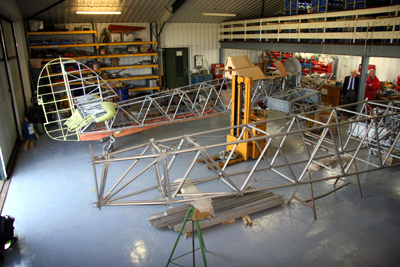

Yes, I do know that Hurricanes are bolted frames. From http://www.spitfiresocietyeastern.org.uk/form 51.html:
"In a hangar adjacent to the airstrip three Hurricanes are concurrently being progressed to airworthy status. G-HRLI belongs to Hugh Taylor and saw RAF service as V7497, construction number 41H-136172, built in 1940 by Hawker Aircraft Limited. The aircraft was shot down over Kent in August 1940. All Hurricane airframe components are joined together using bolts."
  Quote
[ATTACH=full]28035[/ATTACH]
I think it was a Hawker specialty - I believe they machined tricky multi-spigotted tube ends, which were rivetted into place. It avoided de-heat-treating the structure by welding, gave spaceframe structural efficiencies, and made them rather faster to repair from battle damage.
