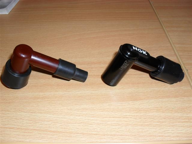

ozzietriker Posted June 27, 2010 Posted June 27, 2010 Gday Chaps, Two of my spark plug caps wobble slightly when sitting on the spark plug head and have no doubt worn out (expected as my engine & trike is over 10 years old). Thought that I might as well replace all of them at the same time so I ordered 4 from Wade Air and was surprised they are different to the reddish/orange ones that I have fitted. These are black 5K Ohm suppressed plug caps LB05EP (pic attached) out of curiosity does anyone have these fitted on their Rotax 582? and will it be safe to fit these plug caps instead? will there be any ill effects to my engine performance? thanks in advance Dennis

ozzietriker Posted June 27, 2010 Author Posted June 27, 2010 Thanks Gents, as I mentioned before that I have only been using the solid post spark plugs. I have never ever used the screw top plugs and getting back to my original question: can I use these black 5K Ohm suppressed plug caps LB05EP pic attached above which were supplied by Wade Air on my 582? will there be any ill effects to engine performance? cheers
facthunter Posted June 27, 2010 Posted June 27, 2010 Specifically... Are you concerned about the fact that a resistor is incorporated in the cap? Nev

ozzietriker Posted June 28, 2010 Author Posted June 28, 2010 Hi Nev, yes exactly - i'm concerned of the fact that a resistor is incorporated in the cap. This concept is used for EMI suppression in motor vehicles, difference being here - the spark produced by the ignition units on a 582 is very weak hence why the spark plug gap is set to only 0.48mm instead of 0.7mm like most other engines. So not sure whether if this resistor incorporated in the plug cap will affect performance, any ideas? thanks in advance
facthunter Posted June 28, 2010 Posted June 28, 2010 Resistor Plugs/Caps/Leads. I do a lot of work with magneto's and open circuited or high resistance secondary (HT) is a bad idea.. Causes point burn and the likelihood of an internal short(arcing) in the coil itself. This is an instant failure when it happens. CDI systems can be killed when a plug lead comes off. (Open circuit). Resistors are installed for radio interference suppression and can have a beneficial effect on plug point life. IF this is not a concern I would NOT use them. You'll get a hotter spark and more reliability without them...Nev
Guest Andys@coffs Posted June 28, 2010 Posted June 28, 2010 I thought the spark plugs used on a 582 had a resistor built into them (BR8ES rings a bell) using a cap that also has a resistor is then a bad idea. That said, I believe there is a non resistive plug with the same (other than resistor) charateristics (B8ES from memory) if the cap then has the resistor and you use the non resistive plug then all is Ok....notwithstanding that its not how rotax make them. So that is an option. The resistor is in circuit in series between the spark gap and the coil. Whether its in the cap or in the plug, between the terminal and the center electrode makes zero difference electrically, though I suggest that the likelyhood of someone, you or perhaps the next owner putting BR8ES plugs back in is high and therefore should be avoided if possible as an option When mine wore out on the 582 I went to a big motor bike shop and got non resistive caps there without any issue, seems they are a commonly replaced part on bikes...And this, in my opinion, is a better option. Andy
ozzietriker Posted June 29, 2010 Author Posted June 29, 2010 Thanks Andy & Nev for your advice, I totally understand where you are coming from and I agree with you both. Fitting those caps would have been a big trap, i'll get the non resisitive type. Can't believe Wade Air sold me that type of cap without asking. thanks again for your help Gents tailwings always Dennis :thumb_up:
