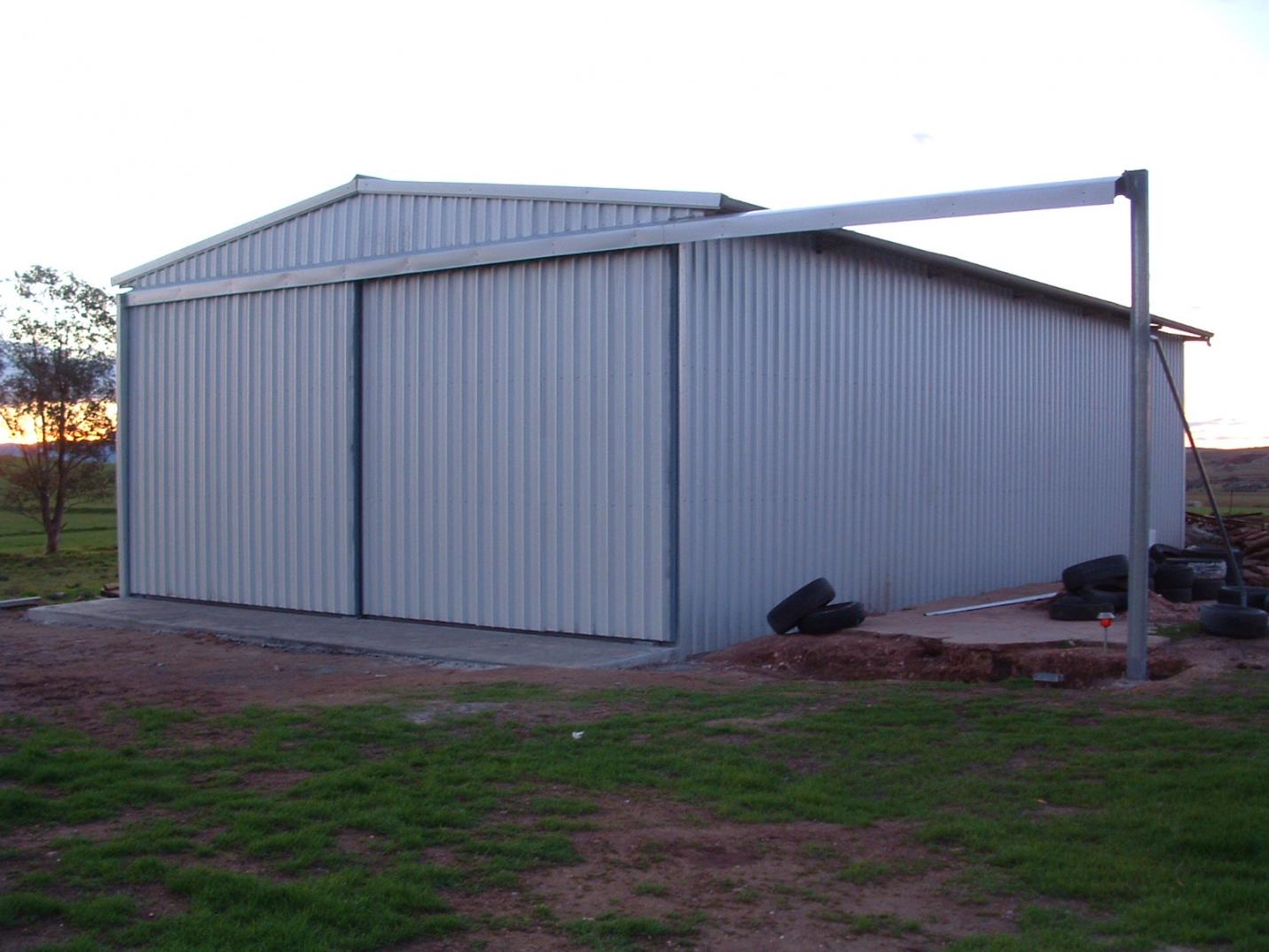

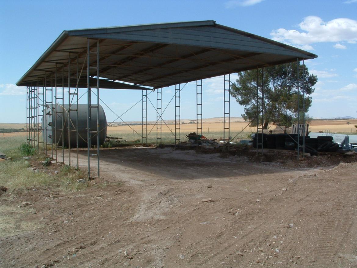

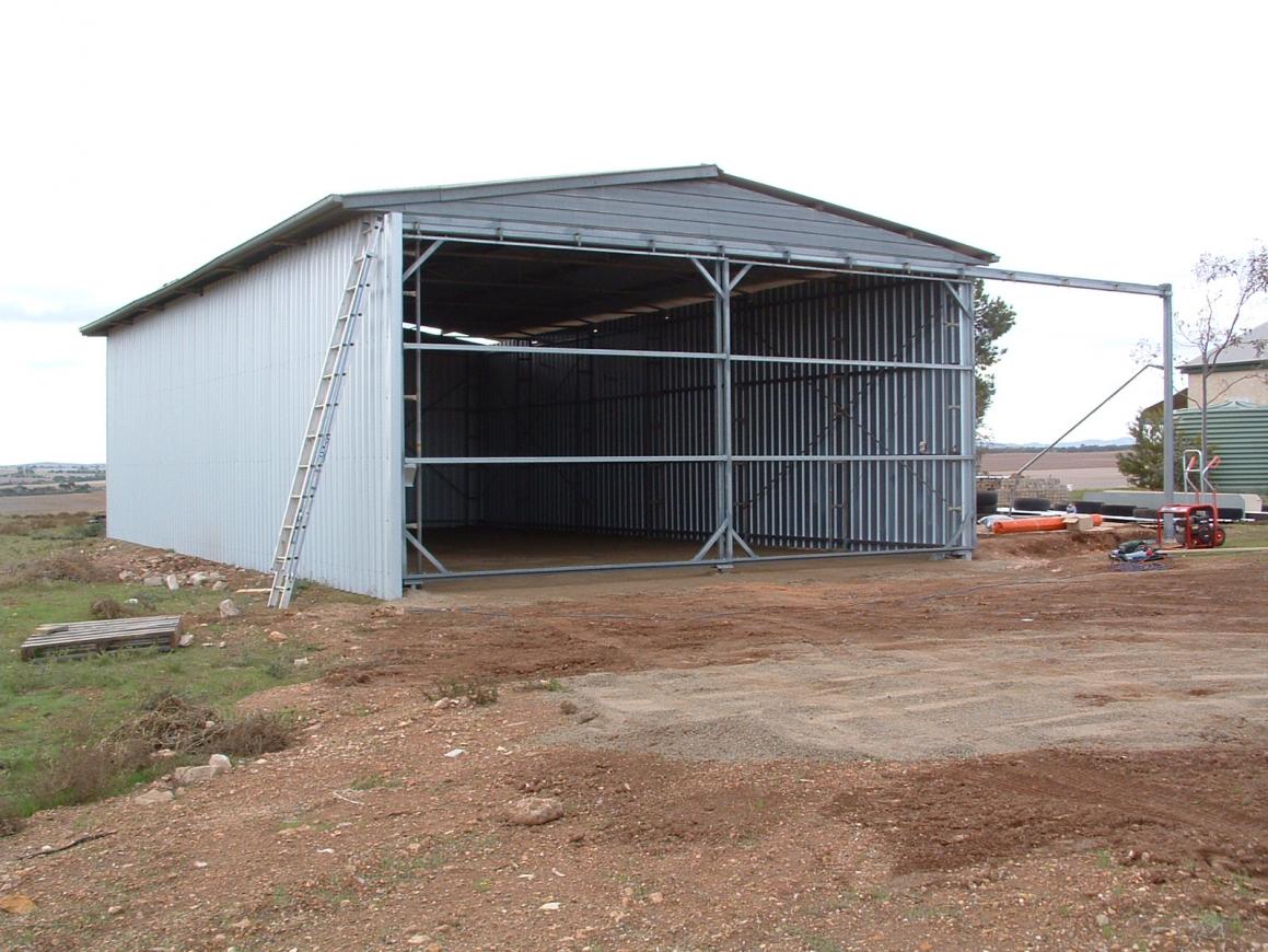

[ATTACH]11697.vB[/ATTACH][ATTACH]11698.vB[/ATTACH][ATTACH]11696.vB[/ATTACH]A bit late to the party, but here's a quick breakdown of building costs, based on the renovation of an existing shed. Everything was ripped down apart from the uprights and the roof.
Groundworks $660, tin & steelwork $6,300, concrete $6,800 (this included making up the level, steel, supply and lay), hired help $900.
It all depends how, where and what you want to build. I was quoted just over $11,000 for a complete kit, (10m x 9m) from one company, although this did not include delivery or concrete.
The way I went was not quick, not easy, and still not cheap, but at least it is finished. The only thing I need to worry about now... is will the plane fit inside!!!!

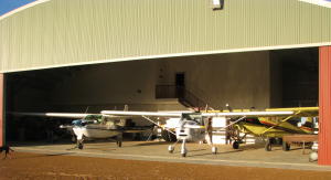

My hangar
Can you identify the 4 aircraft?
