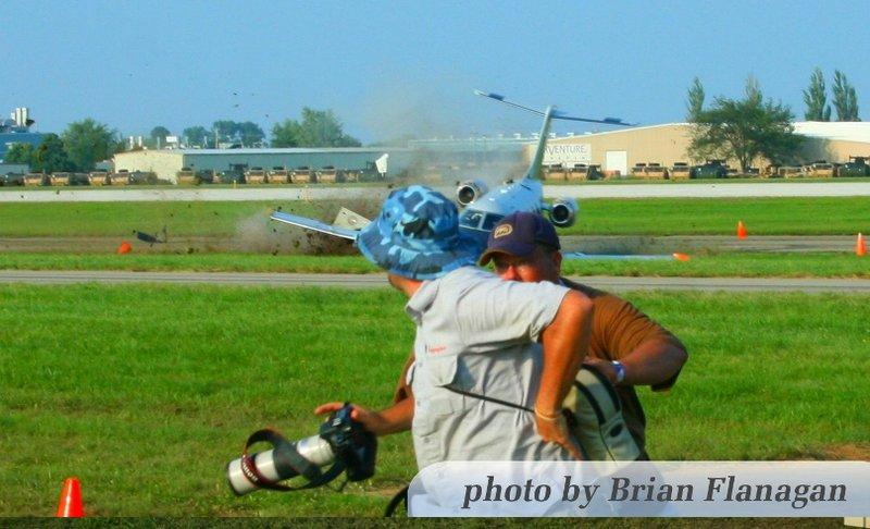

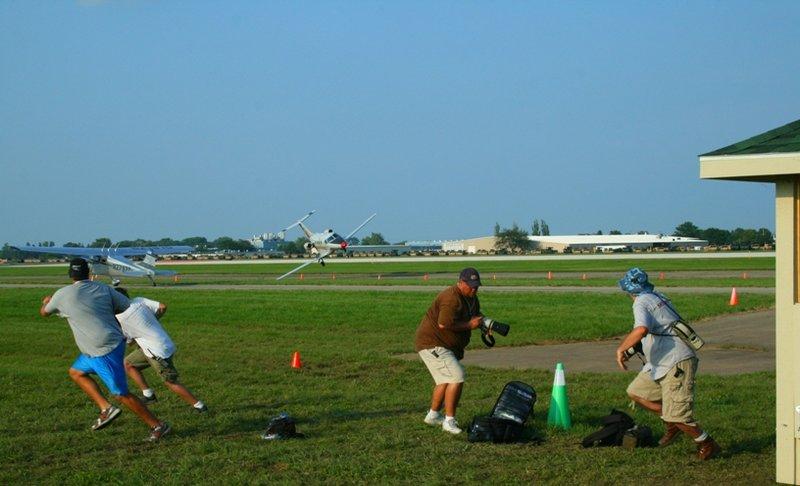

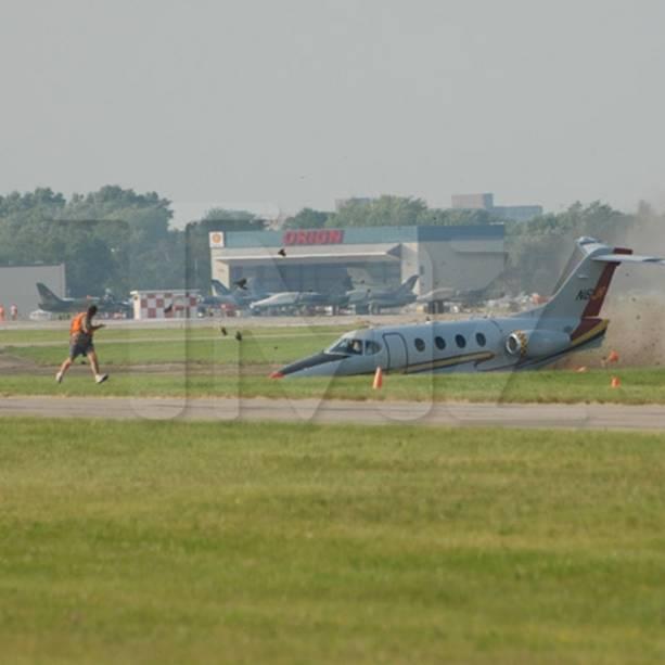

Guest ozzie Posted August 6, 2010 Posted August 6, 2010 yeah nascar team owner Jack Roush is in his late 60's or so. owns quite a few aircraft. and not the first he's busted. scratch one beech premier. some photos taken from another angle show some well equipped photographers missing the money shots and running.
dazza 38 Posted August 7, 2010 Posted August 7, 2010 Ouch, that must have hurt.I reckon some of those Photographers, would have been running very quickly.

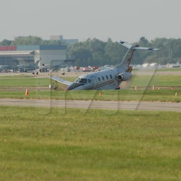

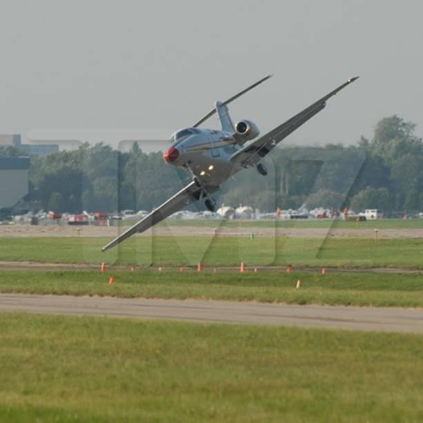

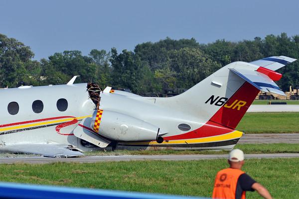

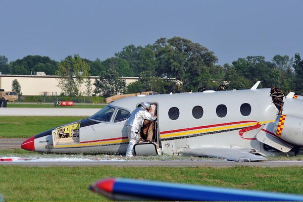

Tomo Posted August 7, 2010 Posted August 7, 2010 Ouch, that hurt. Looks as if he stalled it, and hard!
motzartmerv Posted August 9, 2010 Posted August 9, 2010 Terrible waste of an aircraft, but, i gotta say, that pic of all the camera men doin the harrold holt is priceless.. Im holding back quite a hearty grinn..

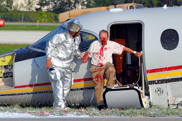

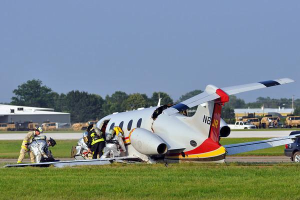

dunlopdangler Posted August 10, 2010 Posted August 10, 2010 WOW...could have been so much worse, I guess his insurance company probably doesn't like him too much at the moment...

facthunter Posted August 19, 2010 Posted August 19, 2010 comment. Most of that does not add up. IF there was not a problem with the engines, (and no-one is suggesting there was). Have to wait for more data. Sad to lose an eye. Should have had an inertia reel 4 point harness in the seat so why the damage there? Don't get it. Nev

Spin Posted September 3, 2010 Posted September 3, 2010 Was sent a couple of new photographs of the crash - must say the one of the wingtip being driven into the dirt makes my blood run cold, I get the impression that a small change in trajectory could have resulted in a much worse outcome. Interesting to observe the position of the elevators and ailerons in the pre impact shots, doesn't look as though that thing was really flying anymore. New underwear for the Cessna pilots?
dazza 38 Posted September 3, 2010 Posted September 3, 2010 Nice shots mate.It would have been scary for the pilots on the taxiway.
