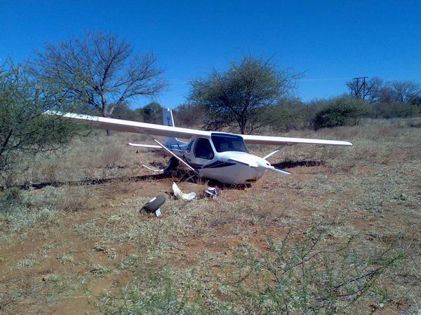

Saw this one on an overseas forum, pilot was approaching an unfamiliar strip on a game ranch when he seems to have misjudged his final approach over powerlines. Interestingly he attributes the relatively good outcome to the fact that he had done a bush flying course and followed the advice NOT to try and power up and over powerlines that suddenly appear on the nose but rather to try and duck under. The theory is that the upper wire (can't think of the name for it at the moment) that runs above the main span will probably catch the undercarriage and trip you into a very steep nose down attitude and possibly fatal arrival. In this instance one or more of the main conductors caught the tail and although it slowed the plane down, it still dropped more or less flat. I'm sure there are circumstances where this wouldn't be the right move, but this bloke came out of it pretty much ok. Tough little birds those Jabbies:clap:
Prop undamaged? Wonder if he was doing a forced landing with nil power?
Seems unusual that it isn't broken if the engine was running. Unless he was quick to turn off when he saw the predicament.
A nice looking aircraft all the same, and a good outcome other than no legs.
I understood it was a powered approach Tomo, iirc he said something about throttle closed, mags off after the first impact which apparently tore off only one of the main gear legs.
Those power lines, shouldnt be used as arrester cables i think.lol. I have seen a few Jabbys over years,damaged in landings.They take impact realy well.

It's safer under - than over in most cases. If you push forward in a hurry - then the top of the fin + rudder will be trimmed off - but the aircraft isn't pitched down as with a wheel hookup = a flatter arrival... as in the pic. Safer again if you are flying trimmed with tail low - so that the highest point is the top of your propellor arc. If this strikes the lower wires - it tends to throw the wire upwards and over the tail section.
