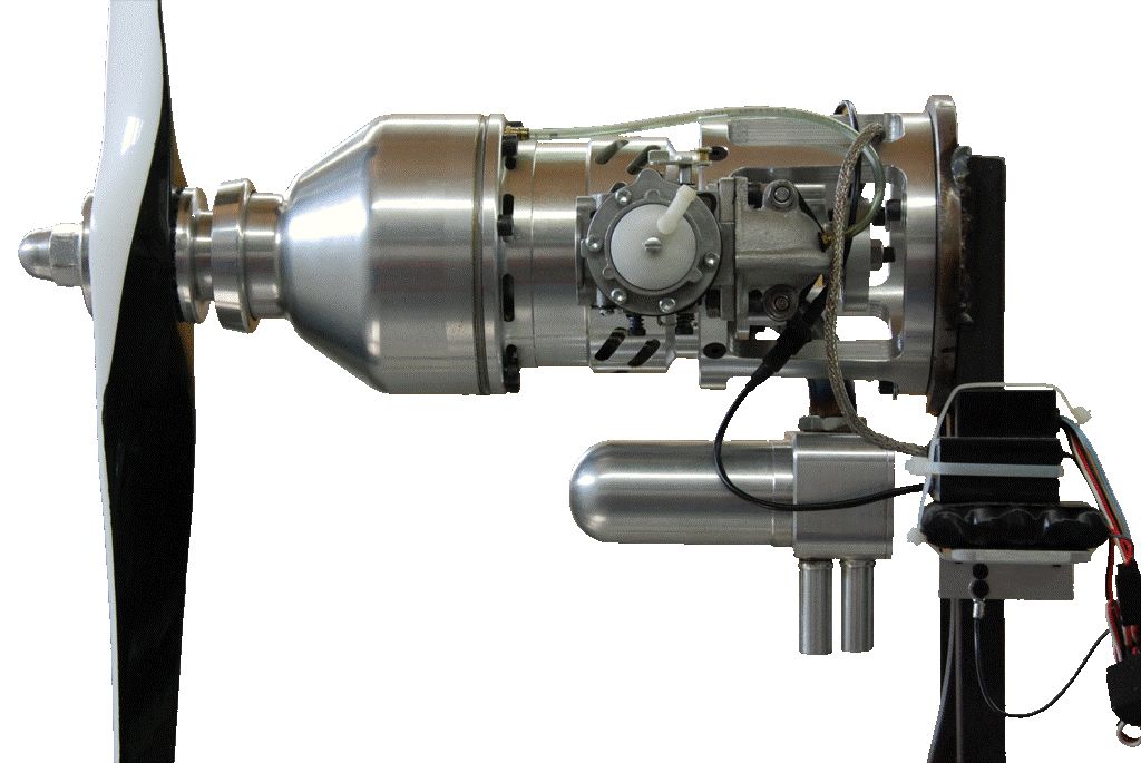

Blackhawk Posted August 17, 2010 Posted August 17, 2010 It looks like someone has finally gone outside square. www.maengtech.com This engine could be the ultimate for aircraft in the years to come; it can be scaled to any size, is very fuel efficient and has extremely low emissions AND SMALLER THAN A TURBINE. The engine in their video is a 150cc Proof of Concept engine and puts out 10HP and weighs 6.3kg Check out the videos; it may be a year or two before they're available, but I cant wait; and the aircraft possiblities are unlimited.

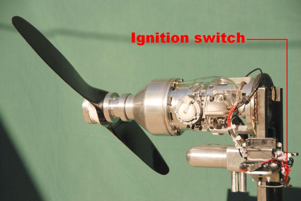

Guest Andys@coffs Posted August 18, 2010 Posted August 18, 2010 Didnt seem to run very long on any of the videos, and in each case the motor seemed to shut it self off ratehr than he did it through the kill switch.... Fuel load in each case looked to be less than an eggcupful. I wonder how cooling will be achieved... perhaps liquid, but I dont think I saw a radiator, perhaps thats why the run times were so short Andy

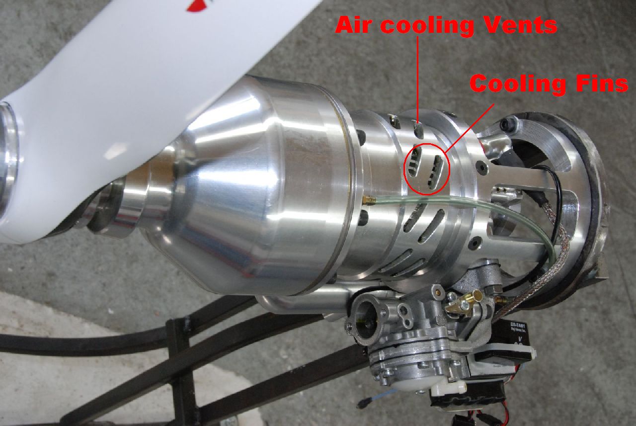

Guest Andys@coffs Posted August 18, 2010 Posted August 18, 2010 According to the pdf.... Dynamic Cooling Now Im feeling that I'm old enough to detect marketing giberish when I see it....and I think I see it. Can anyone tell me what "Dynamic cooling" actually is or means. In traditional terms dynamic means changing and static is fixed. So what changes... I can see that they say the cylinder rotates...but so what? What I couldnt see from the picture of the device was any cooling fins in the airflow Andy

Blackhawk Posted August 22, 2010 Author Posted August 22, 2010 : WOW! to this engine Andy, I asked your question about the engine cutting out by itself and the photo shows the kill swictch . The other photo shows the air-cooling vents and in the circled area you can see the cooling fins on the rotating cylinder.
