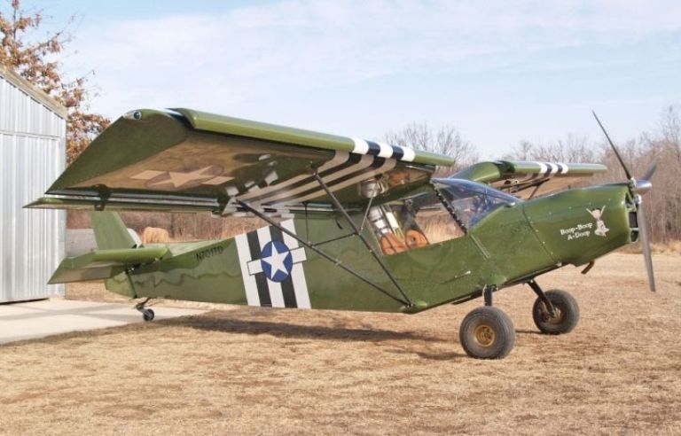

Zenith CH-701 with tail wheel
Hi, the CH-701 is available in tail dragger version and can be built entirely from plans.
Guest Baphomet
And I didn't think it was possible to make that thing any uglier!!
Baph
