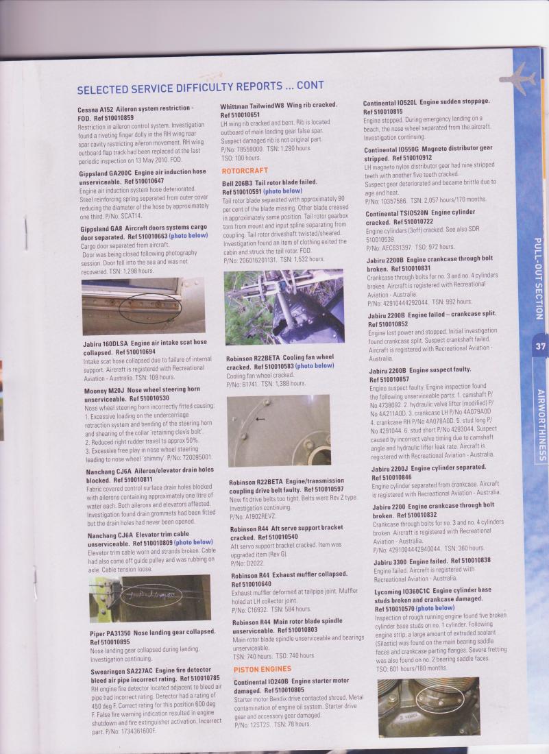

deadstick Posted September 3, 2010 Posted September 3, 2010 Deadstick. You say pay attention to the serial number. Why? What can the serial number tell you? For example my engine is 22A378. What can you deduce from that.My advice would be to talk to people who are running that plane and that engine to see what their experience is. There are an awful lot of jab engines out there and we don't hear of many of them failing, except from a few people who seem to be professional Jab knockers. Hey Yenn, the latest CASA flight safety mag has 6 jabiru engine failures listed for the month, page 37 interesting to see the through bolts still failing. 1 at 360 hrs and the other at 992...
Vev Posted September 3, 2010 Posted September 3, 2010 Through bolt failures is hardly a Jabiru only problem … this was happening on aero engines before Rod Stiff ever consider building an engine and still is. In any case, Jabiru has done quite a lot to fix these failures over the past 18 months which has reduced the incidence significantly. They have modified the engine in a number of ways to engineer out the problem and reduce the propensity of fuel detonation, which is the primary cause of through bolt failure in Jabs. Take a read of the attached “Case Check” in Jabachat for some helpful hints on maintenance procedures, albeit 99% of tool boxes won’t have the tools do the 200 hr checks on the through bolts as prescribed… you will most likely need to enlist an L2 or LAME to perform the checks. http://www.jabiru.net.au/Jabachat/Jaba%20Chat%20August%202010.pdf Cheers Jack
deadstick Posted September 4, 2010 Posted September 4, 2010 Uploaded page Had a request from a french user to upload the page so here it is.
eightyknots Posted September 4, 2010 Posted September 4, 2010 The writing is... ...just a bit too small to read comfortably
eightyknots Posted September 4, 2010 Posted September 4, 2010 Thanks for that tip BlackRod, it was really easy to read that way. It is similarly a concern that there also six Continental engine failures in addition to the eight Jabs listed.
