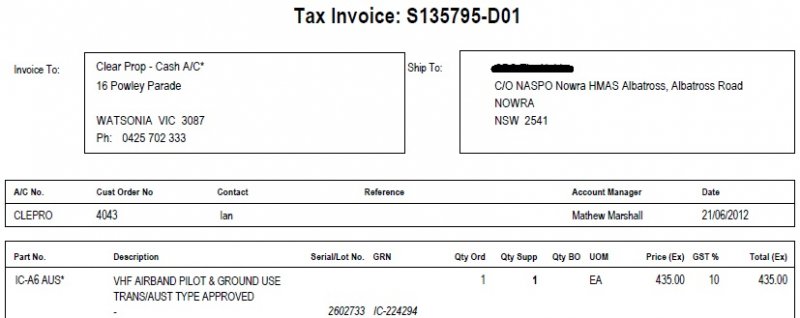

Admin Posted July 30, 2012 Posted July 30, 2012 I heard they went through Avalon Airshow one time and nabbed a whole lot of spectators with non-Australian approved radios. It is not illegal to sell grey imports and these retailers don't care that you are wearing the brunt of the legality of it if you use them. One retailer who is from the UK has been selling many different UK products for years and not caring that YOU are the one that can get into trouble if caught...not them. And, I will be up front here as I feel so strong about how money is the driver of all evil and people don't care about what they do to others for the sake of money but as you will know the shop here sells the Australian APPROVED Icom A6 radio for $495. The actual cost price to the shop as shown in the attached invoice of one from last month is: You can see the enormous amount the shop here makes on an APPROVED Icom A6 radio $435 + $43.50 gst = a massive $16.50 on an almost $500 unit so you can see which retailers are really ripping you off with grey imports just for money
