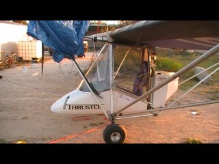

I must have a T83EH... as mine has a inclosed cockpit (with doors) and the tank filled in with a spoiler attatched,but no flaps,sure would be to get confermation from the man himself!!R.I.P Tony.P9.jpg.27feb45dcee5ba6e41cccae5e1345da3.jpg
