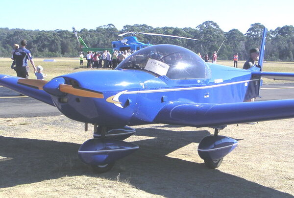

wanabigaplane Posted September 16, 2010 Posted September 16, 2010 [ATTACH]11932.vB[/ATTACH] I attended the recent Moruya fly in and saw this plane for sale. In excellent condition. Jab 3300, Low hours, does 105 knots. $48K. It sounded too good to be true. I did my due diligence and it checked out fine. My only concern was that it lived by the sea with subsequent concerns about corrosion – but it had not been there that long. Hmm. A bit more digging. That Zenith website says it stalls at 47 knots. Well that’s pretty close to 45 knots. Would RAAus let it be registered? I decided to visit Steve Bell at the RAAus offices to make sure. The conversation went pretty much like this: If it does not stall below 45 knots, it cannot be registered under RAAus. But aren’t some already on the register? Yes, but I don’t know how they got there – before my time. Could they have done something like lowering both ailerons, or some modification? I would be surprised if that would be enough to do it. If you bought the aircraft and the mod was not enough, you would be stuck with an aircraft you couldn’t register. 45 knots, 47 knots – there is not much difference. Is the ruling that black and white? Yes it is - The ruling is by CASA, not me. Recently they reviewed two aircraft already on the RAAus register, and they had to be de-registered. It is hard to tell that precisely what speed it stalls at. If I say it was 45 knots, that’s good enough isn’t it? No. I will ask you to demonstrate it. So, as you can see, I did not buy the aircraft.

wanabigaplane Posted September 17, 2010 Author Posted September 17, 2010 Anyhow.. The plane is advertised in the latest RAAus mag. I only made this post so that any other forumites who might be interested in it would be forewarned about a possible difficulty of registering it under RAAus. Thanks Cameron, but there is no need to make any further investigations - I am fully satisfied that the plane is in excellent condition, that the owner is fully above board, and that all work has been done by your local lame. It is really good value for the money, and I don't question the price at all. Thanks for the info on VGs - they lowered the stall speed of that one particular plane by 3 knots. A little too close for comfort for me. As Steve said, if I bought the plane, and I could not prove it stalled at under 45 knots CAS, I would be stuck with an aircraft I could not register. I really cannot afford the time to be trying this and going for tests, then trying that and going for tests, and be chasing down variable after variable. Jack.
