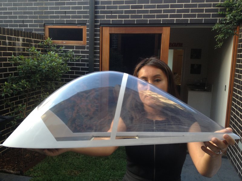

Gforce Posted June 14, 2013 Posted June 14, 2013 The Cri Cri has always been a must have/really want homebuild for me but alas, at 95 Kgs, and 6.4 I will never fit. The maximum pilot weight in the POH is 72 Kgs anyway... So, I`m doing the next best thing. Building a LARGE RC version of it. There is 2 electric 1:1 scale Cri Cri so I will be building mine as a scaled down 38% Model. Here is a video of the full size Electric Cri Cri Mine will be powered by electric brushless out runners on 12 cell Lipos ! Here is a picture of my wife holding the canopy of my RC version. Yep.. its BIG ( for a small plane )
