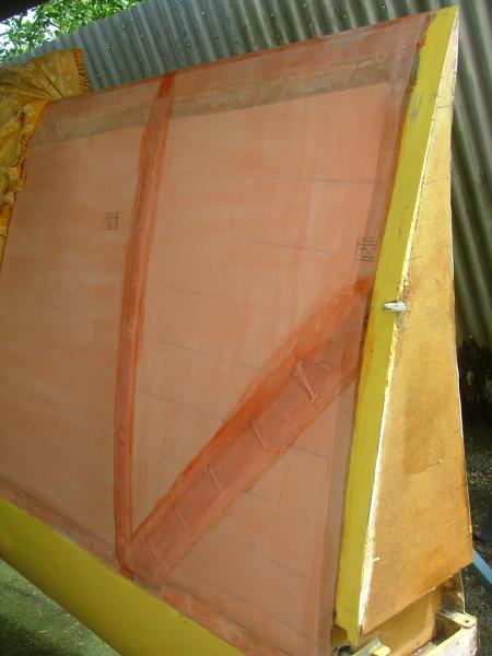

RickH Posted January 8, 2011 Posted January 8, 2011 Hey OME Check out the Stits manual couple of very good methods for rib stitching including one that alows you to end up with the Knot in side the the wing under the fabric all you end up wih on the surface are the cross over threads. Regards RickH . [ATTACH]12837.vB[/ATTACH]
Guest Maj Millard Posted January 8, 2011 Posted January 8, 2011 One thing often neglected with ribstitching, is people do not run a re-inforcing tape along the top of the rib (on outside), before rib- stitching. This one step alone increases the strength considerably, by decreaseing the chance of the stitch pulling through the fabric only, and now has to pull through two thicknesses of fabric. Well worth doing for little extra weight and twice the strength !..A recommended proceedure in the industry...........Maj...
