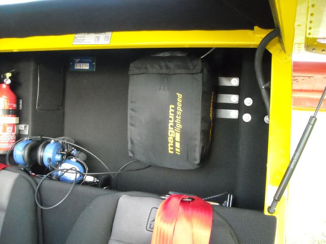

Kyle Communications Posted February 17, 2011 Author Posted February 17, 2011 Hi Massimo Can you take a couple of photos of your ballistic parachute and how its installed please so I can get an idea of how they have done it. Also do you know of anyone that has had to deploy one? Mark

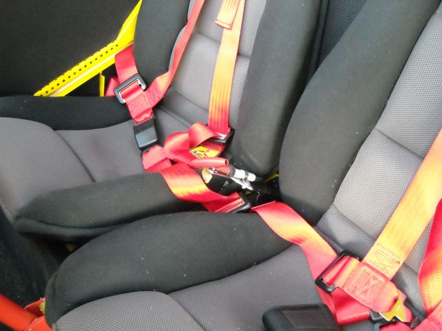

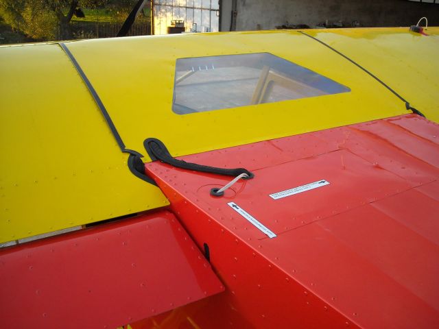

Kyle Communications Posted February 20, 2011 Author Posted February 20, 2011 Hi Steve Massimo sent me some pics of his although its a 475kg one. And I noted it looks like the extra baggage space was removed. The extra baggage space isnt a be all and end all for me...the mrs was asking about them and would feel more comfortable if we had one in it. I gather Reg has not fitted any yet?..the factory fits them on European versions and there is a law change there this year about compulsory use of themas in Massimo's message below which may eventually come here. The softpack for our versions would need to be the 600kg ones as I think over there they are only allowed 450KG MTOW that would be me and about 35litrs of fuel :(...glad ours is at least 544 Mark
Kyle Communications Posted February 20, 2011 Author Posted February 20, 2011 Hi All I asked Massimo if I could post the pictures of his factory install of the Lightspeed 501 softpack ballistic chute in his factory built Savannah so here they are for reference for anyone interested
eightyknots Posted February 20, 2011 Posted February 20, 2011 Quote Hi AllI asked Massimo if I could post the pictures of his factory install of the Lightspeed 501 softpack ballistic chute in his factory built Savannah so here they are for reference for anyone interested I noticed that our Italian friend that owns the Savannah uses the Lightspeed 501. ICP's website says the following about the Savannah XL: It’s possible to install a parachute “Junkers 500” type. I wonder if this is perhaps the 600 kg version? Perhaps the Australian importer could find out some more? ...or do a package deal to keep the cost reasonable??
Kyle Communications Posted February 20, 2011 Author Posted February 20, 2011 Hi 80Kts I rang Tom this morning and sent him the pics as well. I have asked him to chase the factory up on this for 600kg softpack chutes. and any drawings or other info from ICP about retrofiting them into built and also under contruction XL versions for here. It is interesting that this is becoming law this year in Italy and Tom tells me in Germany it is mandatory for all microlights and ultralights. My Mrs is pushing the barrow on this one so it looks like I don't really have any choice in the matter as she would like some sort of failsafe. She is across pretty much everything I do with the sav and was extremely interested in it after reading the emails from Massimo. I know I am trying to save as much weight as I can and it looks like my weight saving measures so far will be taken up by a ballistic chute Mark
