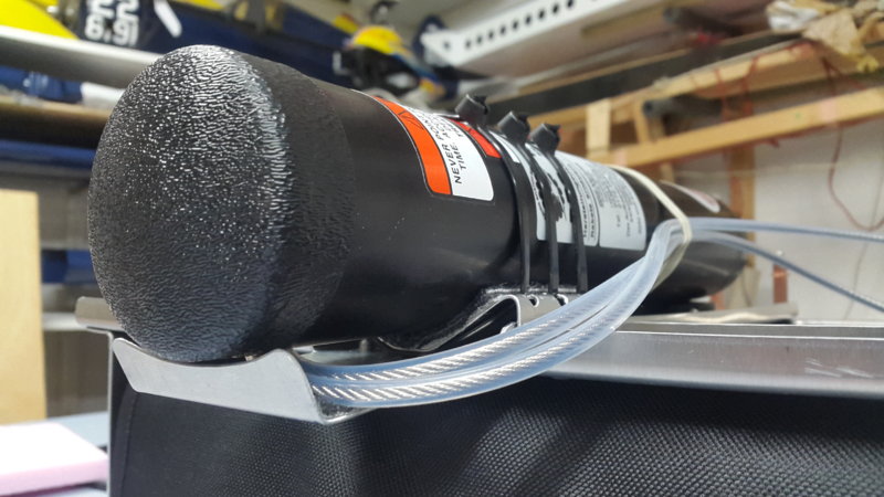

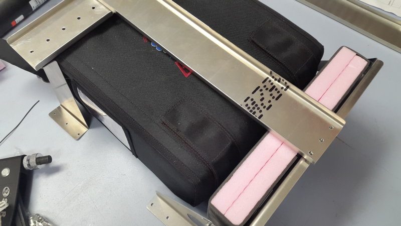

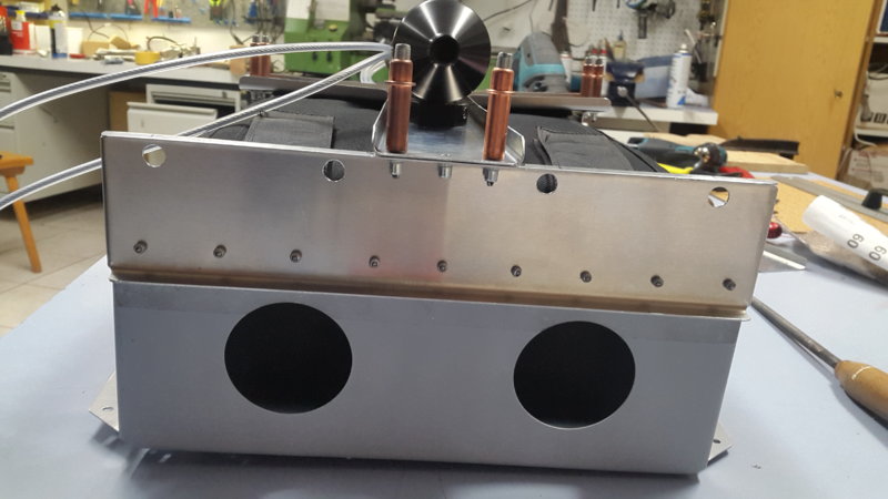

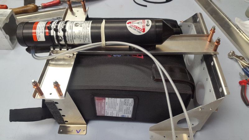

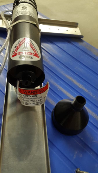

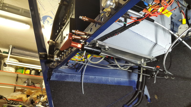

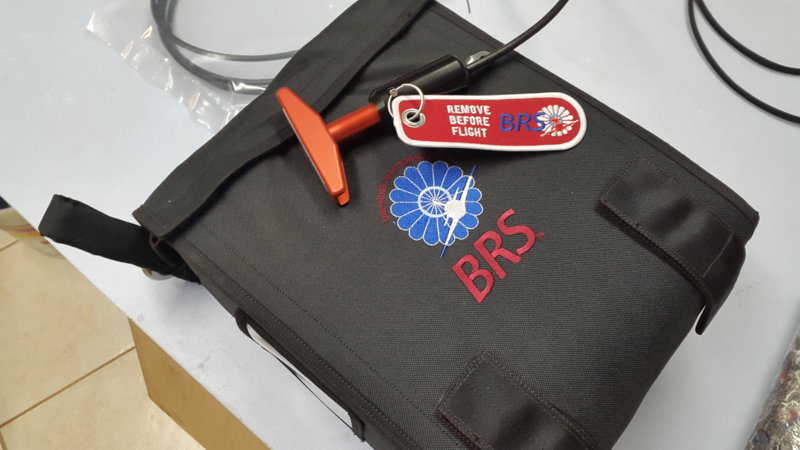

I use the easter weekend to install my BRS Parachute... this version is much more compact than the junkers system
