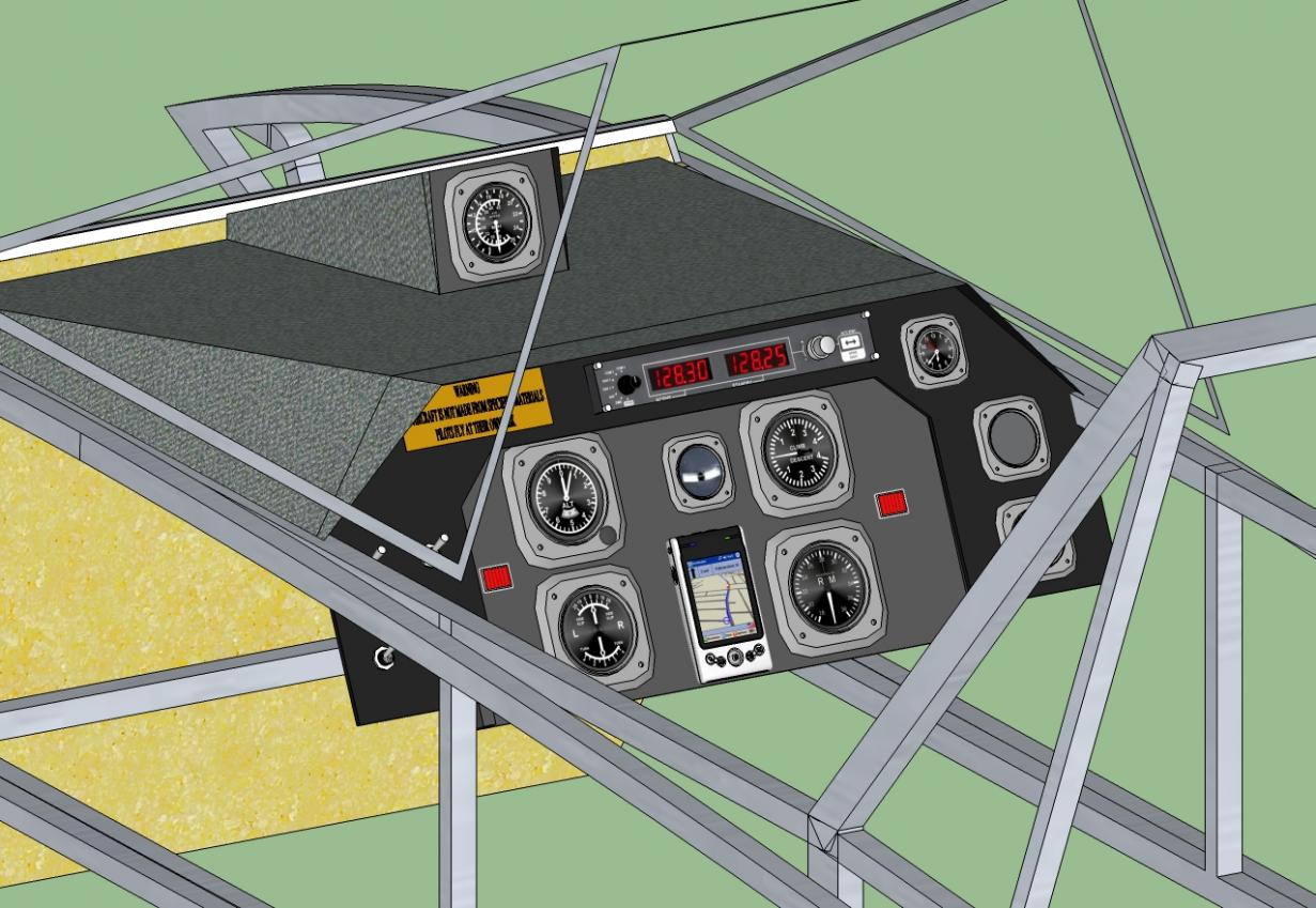

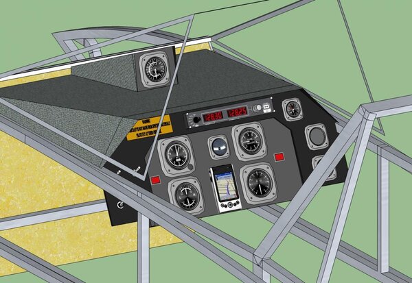

Deskpilot Posted October 14, 2010 Posted October 14, 2010 Yeh, each to his own, but seeing as you see more of your panel than any other part of your aircraft, it might as well be interesting, hence my 'fighter? style' Gauges shown are temporary and the best I could download from the Google library. Same goes for the GPS, road version.
