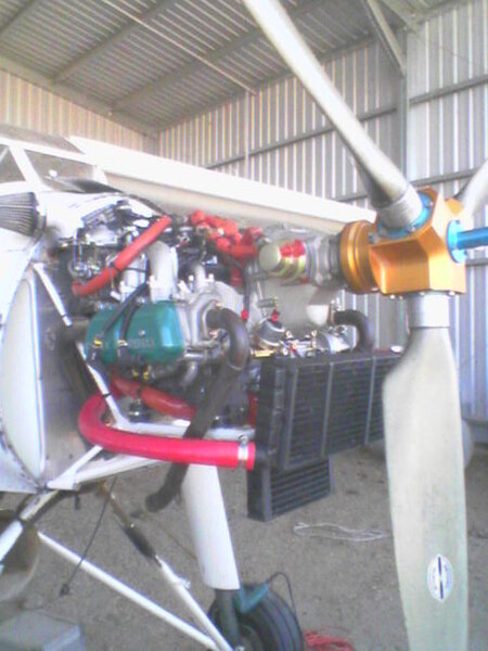

I have been flying an lsa 55 that was certified with an 80hp Rotax for 5 years, it is one done at Rockhampton. Never had any trouble, good airframe with great reliable motor and warp drive 3 blade carbon prop. For weight and balance the oil tank is behind the pasenger seat and battery is behind the fuel tank.
Do you have any pictures of the fit up of the engine ?,How did you get a 55 rego plane changed to a rotax mtr ? i was told by Jabiru I could even change the heads on my 55 rego to LCH
