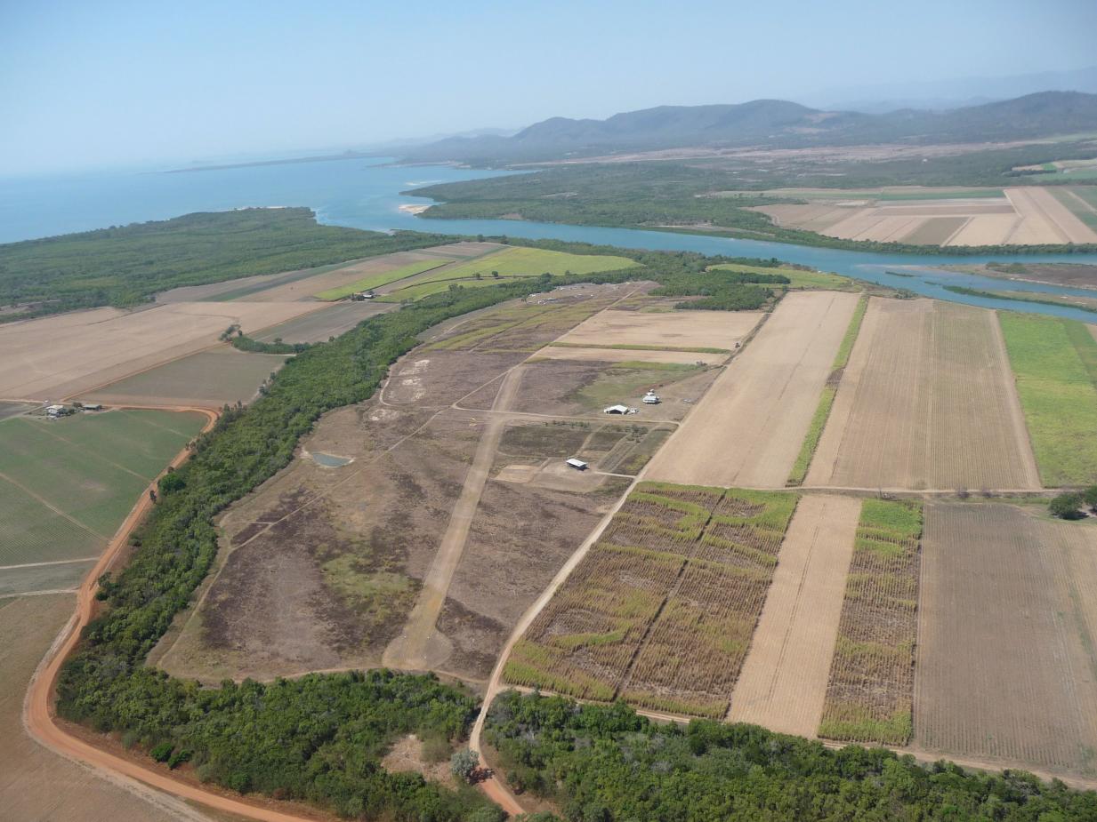

farri Posted November 4, 2010 Posted November 4, 2010 Ian, A shot of my place,area east of the black line,I`m 45 k south of Cairns, if you ever fly up here,come in,the strips 600 mts long. Lat 17.13.110 Lon 145.56.087 Cheers Frank.
ianwells Posted November 5, 2010 Author Posted November 5, 2010 Hi Frank You're place looks alot like ours! We'll try to get up youre way once the savannah gets launched and we get a bit more range than in the drifter. We did once fly to the northern territory and back in the drifter, but it took three weeks! What are the beaches there like? hard sand? Ian

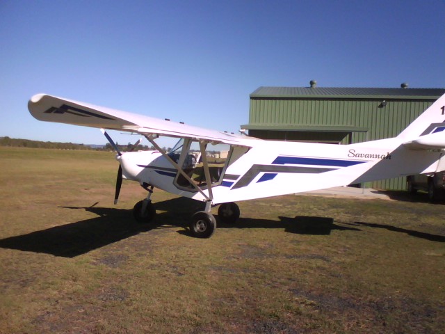

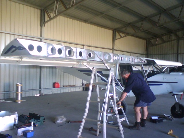

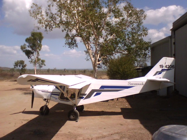

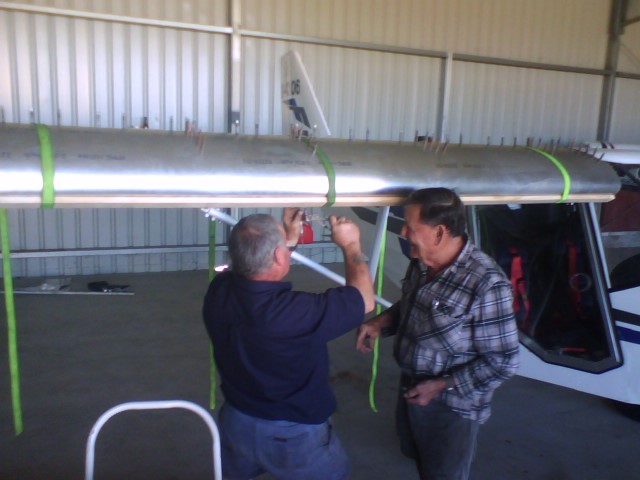

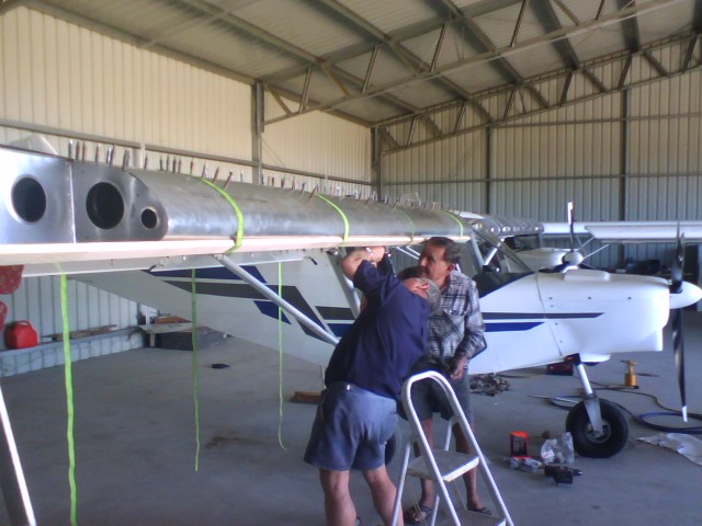

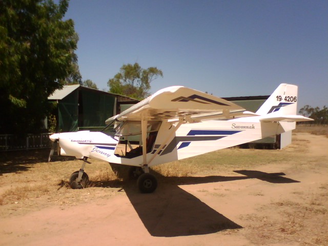

Guest Maj Millard Posted November 5, 2010 Posted November 5, 2010 Ian some shots of Savvy 19-4206. We did the VG Leading-edge mod prior to leaving Casino. I flew it up to Ingham where it now lives, in 10 hours.(leasurely) Notice the use of the piece of wood and rachet straps for LE skin attachment. This works well to achieve a good fit for the LE d-cell skin. Be sure to also fit the third door fastener, if they haven't already incorporated it into the XL kits. If not used the doors can get ripped off if they open in flight, and damage the tailplane as they depart...........................Ross.
