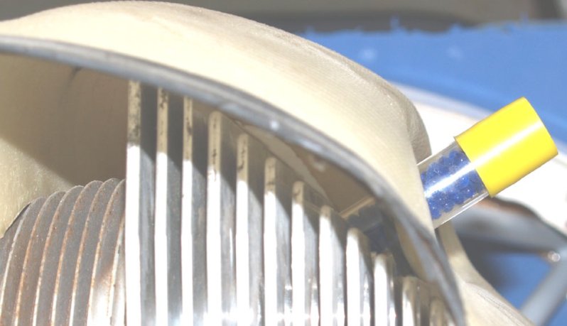

jetjr Posted May 31, 2015 Posted May 31, 2015 Inhibitor http://camitaeroengines.net/collections/ancillary-parts/products/engine-inhibitor-unit Camits plumbing isnt as neat as the Sonex pictured Jab process involves putting oil down carb, not easy 1

facthunter Posted May 31, 2015 Author Posted May 31, 2015 If you inject oil it has to get where you need it. If you trickle it into the manifold it's likely to only go to one place along the lowest part. Fine spray under pressure works better. The dessicator plug is good A squirt of DWF at the time wouldn't go astray either. I suggest outboard oil diluted with avgas. sprayed. Nev
