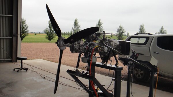

Here one that should get your juices going.
This is a project that I have being working on for the last couple of months hope you enjoy.

G`Day Kingo,looks interesting, some explanation of it will help everyone.
Cheers,
Frank.
Guest Maj Millard

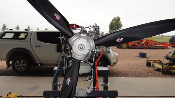

OK Kingo, 582 gearbox, Bolly 3-blade prop....question is how much horsepower does that International harvester Solar turbine put out ??????..................................Maj...024_cool.gif.7a88a3168ebd868f5549631161e2b369.gif
woohooo way to go. hmmm 150shp, work those exhaust stacks a bit and you'll get more thrust.

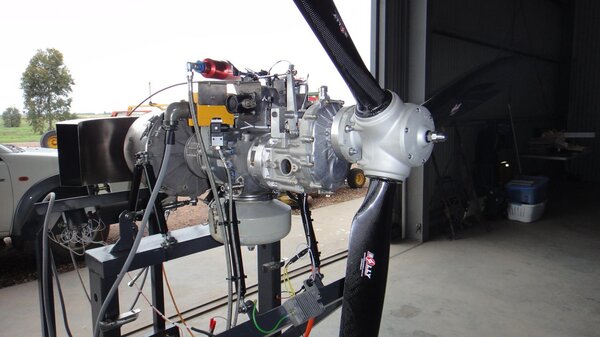

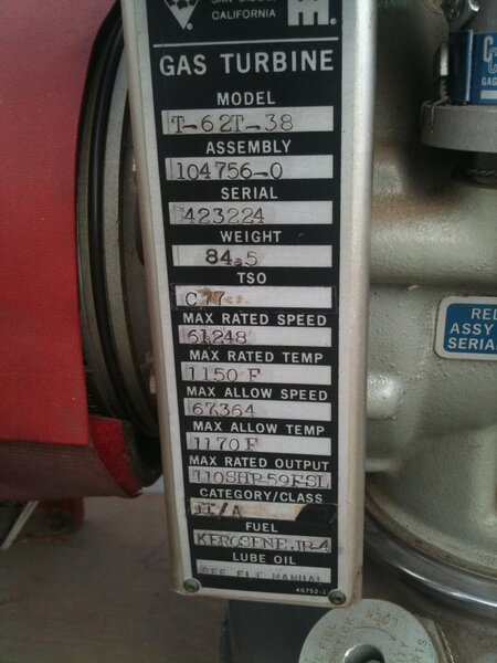

Hi frank,Maj,Ozzie and all, Its a Solar T62-27 gas turbine APU, which I'm told is out of a CH53 helicopter,
I like these engines over the very common T62-32 ground base generator, they are less hp but also a lot less weight, the engine you see is 37 kg with its gear box, and it also has a right angle drive, which use to drive a 12kva 3 phase generator.

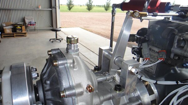

This gave me great access of my starter, the engine has a manual fly weight governor and an altitude compensator for rpm control, and this work faultlessly.

Kingo, Wouldn't you have been better to use a 912 gearbox with the straight cut gears and designed to handle more horsepower ?....just wondering......you'r more than welcome to use my Lightwing as an inflight testbed if you like....I'll even volenteer as the test pilot !!....not sure if you will get the engine back though.................Maj...024_cool.gif.7a88a3168ebd868f5549631161e2b369.gif
Maj. could not get the 912 ratio right, its 8200 out of turbine gearbox, and I'm happy for now with the C box as this engine has no shock loading unlike a piston engine.
