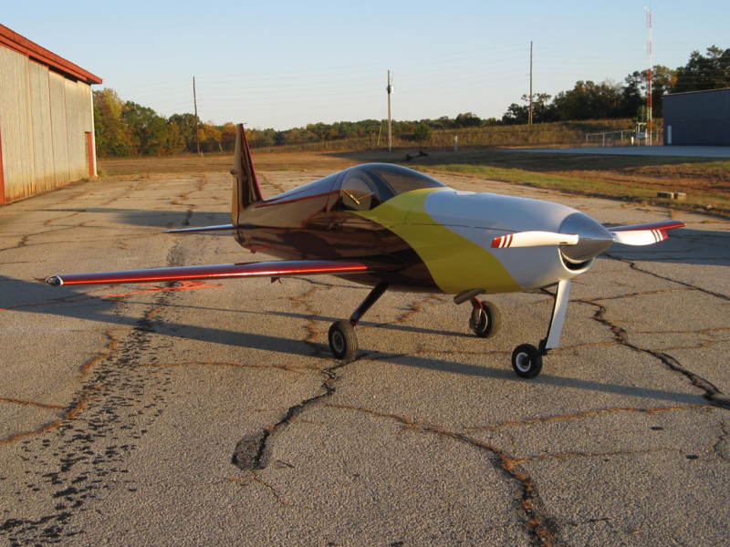

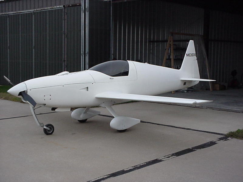

flyvulcan Posted October 31, 2012 Share Posted October 31, 2012 How long is it, Brett? The engine that is, from prop flange to aft of the exhaust? Could you redo the exhaust for tractor configuration? After successful airborne testing on a gyro and if it physically fitted, perhaps you might be interested in fitting it into this actual aircraft: You would be doing faster than 160 knots (normal top speed with 100hp 2 stroke is around 200kias with a Vne of 225) and it only has one seat. We could come to some arrangement... It's ready to fly (done around 40 hours already), it just needs to be re-engined (we wont be flying it again with the AMW that's in it!) Dave Link to comment Share on other sites More sharing options...

flyvulcan Posted October 31, 2012 Share Posted October 31, 2012 It is called a Lightning Bug. It was designed and released as a kit in the US in the early '90s but the designer finished up production after 16 kits due to the fear of liability. Myself and a mate have purchased the remaining kits/components/molds/tooling etc. and rights for the Bug from it's former owner with the intention to refine and release the Bug in kit form. We have the Australian demonstrator under construction in Adelaide and that one is receiving a Jab3300 (tin hat on!!) which should be flying next year. The one in the photo is our US demonstrator, but we are in the process of selecting a suitable powerplant for it. Once selected and fitted, we will thoroughly test the aircraft so that we can release accurate and verifiable data on it's performance. It has wheelpants yet to be fitted to finish off the cleaning up of the airframe. Here is another Bug photo of one that has flown in the US: I used a Bug kit as the basis for my Komet jet project which could be the second product off our production line, given the large commonality of parts. Cheers, Dave Link to comment Share on other sites More sharing options...

flyvulcan Posted October 31, 2012 Share Posted October 31, 2012 If my personal one works as anticipated, yes Howie, we will be looking at making it available as a kit, given that we already have the molds and tooling for most components. Bear in mind that it is intended to be a purely fun machine, not at all practical. And the engines are thirsty!! However, with a completed price of under that of many LSA's, there may be some people that are interested... The wings should be finished in 3 weeks, the tailplane is complete and mounted and I have some big build sessions on the fuselage coming up. By Christmas, it will really be looking like the real McCoy. Keep an eye on my threads here and here for updates on progress. Cheers, Dave Link to comment Share on other sites More sharing options...
facthunter Posted October 31, 2012 Share Posted October 31, 2012 Have you considered a racing rotary as used in outboards? They have good characteristics for a fast plane. Turbine engines (small) will be very thirsty and you probably need a complex prop. Nev Link to comment Share on other sites More sharing options...
flyvulcan Posted October 31, 2012 Share Posted October 31, 2012 Hi Nev, If anyone can point me in the direction of a suitable powerplant for the Bug, I'm all ears. We have a few under consideration but all of them are compromises on the original concept of a closely cowled 100hp 2 stroke. We may still put the fairly bullet-proof Rotax 912/914 in it, but we've looked at all the 2 strokes (Hirth/Simonini etc.), the D-motor, Jabiru, AeroVee, etc. and we don't have a "perfect" engine yet for it. The main feature of the Bug design is it's capability for real speed (i.e. 200 knots) but to make the Bug a success, it must have a suitable, reliable, affordable powerplant. We've looked at several rotary conversions but have not found a suitable one yet. If you know of any, please let me know in case we haven't yet seen that product. Bear in mind that engine bay space on the Bug is at a premium. As for a prop, with the large speed range of the Bug (60 - 200kias), we are looking at IFA props to maximise it's performance potential. The existing props start running out of pitch at around 180 knots so we are definitely looking at IFA options for the "performance" Bug. A "regular" Bug would be ok with a fixed pitch prop up to around 180kias, but for those with the real need for speed, we will definitely be working with an IFA prop maker to provide an optimum performance prop for those who are pepared to pay the extra for more knots. If Kingo's T62 conversion is viable and reliable, and we could organise for conversions to be made readily available (such as Helicycle do with their T62 conversions), it might be a nice option to be able to offer for the Bug. This is why I am watching Kingo's conversion with interest and would be keen to see it in a Bug, once it had a history of safe operation in a gyro. Cheers, Dave Link to comment Share on other sites More sharing options...
eightyknots Posted October 31, 2012 Share Posted October 31, 2012 Hi Nev,If anyone can point me in the direction of a suitable powerplant for the Bug, I'm all ears. We have a few under consideration but all of them are compromises on the original concept of a closely cowled 100hp 2 stroke. We may still put the fairly bullet-proof Rotax 912/914 in it, but we've looked at all the 2 strokes (Hirth/Simonini etc.), the D-motor, Jabiru, AeroVee, etc. and we don't have a "perfect" engine yet for it. The main feature of the Bug design is it's capability for real speed (i.e. 200 knots) but to make the Bug a success, it must have a suitable, reliable, affordable powerplant. We've looked at several rotary conversions but have not found a suitable one yet. If you know of any, please let me know in case we haven't yet seen that product. Bear in mind that engine bay space on the Bug is at a premium. As for a prop, with the large speed range of the Bug (60 - 200kias), we are looking at IFA props to maximise it's performance potential. The existing props start running out of pitch at around 180 knots so we are definitely looking at IFA options for the "performance" Bug. A "regular" Bug would be ok with a fixed pitch prop up to around 180kias, but for those with the real need for speed, we will definitely be working with an IFA prop maker to provide an optimum performance prop for those who are pepared to pay the extra for more knots. If Kingo's T62 conversion is viable and reliable, and we could organise for conversions to be made readily available (such as Helicycle do with their T62 conversions), it might be a nice option to be able to offer for the Bug. This is why I am watching Kingo's conversion with interest and would be keen to see it in a Bug, once it had a history of safe operation in a gyro. Cheers, Dave Have you considered a 110hp Viking engine? Link to comment Share on other sites More sharing options...
