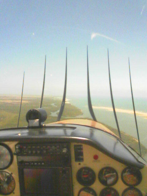

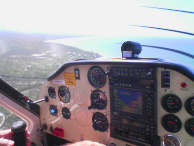

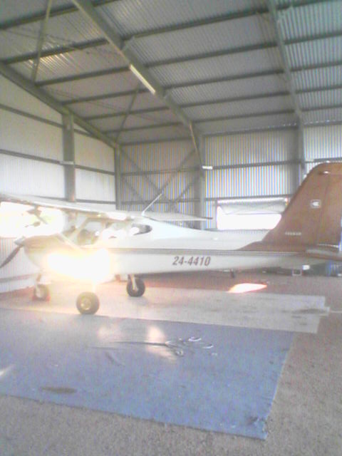

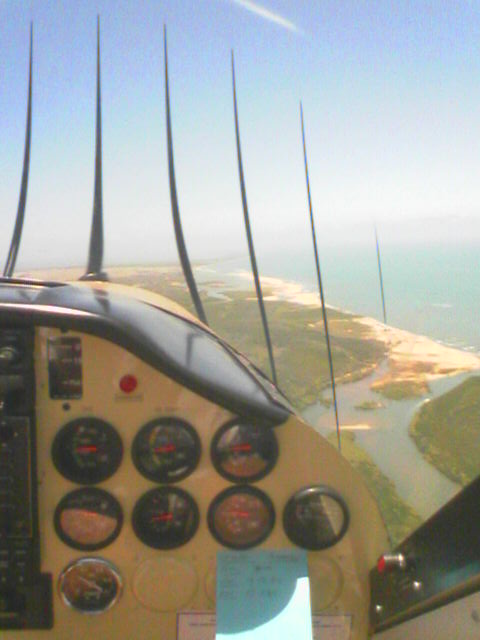

All pretty much the same plane and wing etc....but with different fit out and engines etc. so therefore different performances. The standard P92 or super Echo are both very nice aircraft with good top end speed (I've seen around 109 kt cruise) and very stable low-end approach speed of around 45 kts. They are very comfortable cockpit wise, and make a great xcountry aircraft with room for gear. I'll attach some photos of the one I flew, it had top-end equipment with hot radios/gps, tinted windows, custom factory paint and other extras. There have been a couple of Service bulletins out on them but nothing that can't be taken care of, especially if you pick one up at the right price. The one I flew had an Airmaster Constant speed/variable pitch prop on it which livened it up no end, I have not flown one with the standard 2blade prop .They are a quality piece of Italian gear with a fairly high initial purchase price...........................cheers............... Maj...024_cool.gif.7a88a3168ebd868f5549631161e2b369.gif
