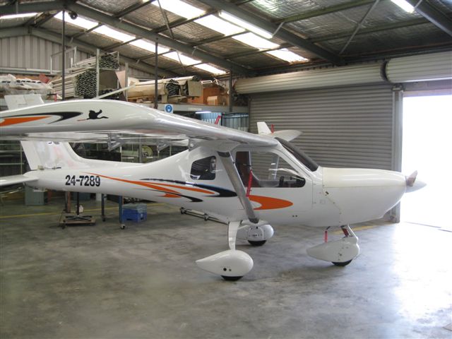

RKW Posted November 25, 2010 Posted November 25, 2010 While visiting the Jab factory earlier this month, I saw what may be an upgrade of the J170. It has an extended nose (and engine mount) uses the J230 virt stab and has a new and larger ventral fin. Why the need for the changes...I have no Idea! Regards, Bob 1
RKW Posted November 25, 2010 Author Posted November 25, 2010 Here is a photo of the J170. The new ventral fin is not attached. [ATTACH]12548.vB[/ATTACH] 1

Ballpoint 246niner Posted November 25, 2010 Posted November 25, 2010 Hey Bob , my understanding is they'retrying the longer nose to get the CG fwd with the extended engine mounts so they can use the generous luggage area and the 600kg MTOW to allow more luggage to be carried in the aft cg position. Changing the nose to the longer cone as on my 120 means they have to redistribute the longitudinal forces- particularly in spin recovery, so hence the larger tail- also will increase the rudder authority, something jabs are a bit short on. You may have seen the dataloggers and telltales all over it- part of the testing requirements for re-certification.
RKW Posted November 25, 2010 Author Posted November 25, 2010 Yes Neil, it sure looked like a testbed. It even had vortex generators at some stage. I saw the mould for the new ventral fin. It looked to be twice the size of the standard one.

RKW Posted June 20, 2011 Author Posted June 20, 2011 Anyone got any update news on the "new" (long-nose) J170; info or 'spy' pics? Hello Bushpilot, the 170 in my photo has the long nose. Regards, Bob
