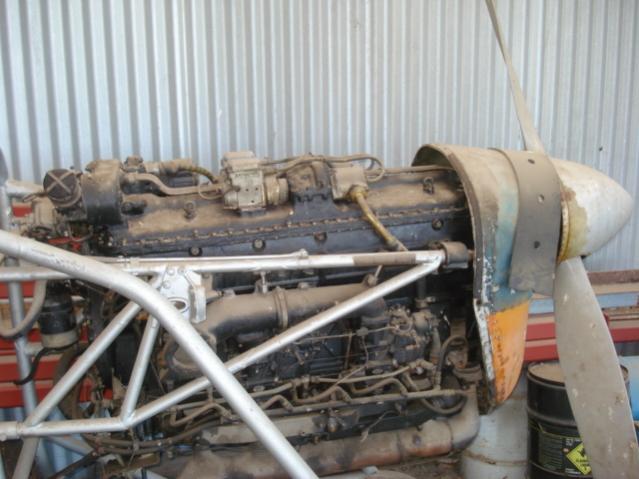

Guest ozzie Posted December 6, 2010 Posted December 6, 2010 any idea what this is and what it came out of? Looks British. 6cyl with fuel injection.
Guest eland2705 Posted December 7, 2010 Posted December 7, 2010 With that little bit of cowling, I would hazard a guest at something Mr. De Havilland produced. Could be a one of twin? Guessing!
stanzahero Posted December 7, 2010 Posted December 7, 2010 Name the engine De Havilland Gypsy Queen? From the Dragon Rapide? i_dunno
dunlopdangler Posted December 10, 2010 Posted December 10, 2010 I am with Stanz...most likely a gypsy queen mark 2 engine.by the look of it...powered the Percival Prentice (is that what it is attached to?) As well as the heron..I think
Guest ozzie Posted December 10, 2010 Posted December 10, 2010 This engine is just sitting in a display stand in the corner of a open hanger at Luskintyre. The ID plate is a bit faded and worn. Fixed pitch timber prop. I have no idea what it is out of.
facthunter Posted December 11, 2010 Posted December 11, 2010 Dehaviland . Supercharged. Heron or Dove, Gypsy Queen? , 6 cyl in-line CS prop OOPS Fixed pitch wooden prop. Gypsy 6, Percival Proctor? Nev
