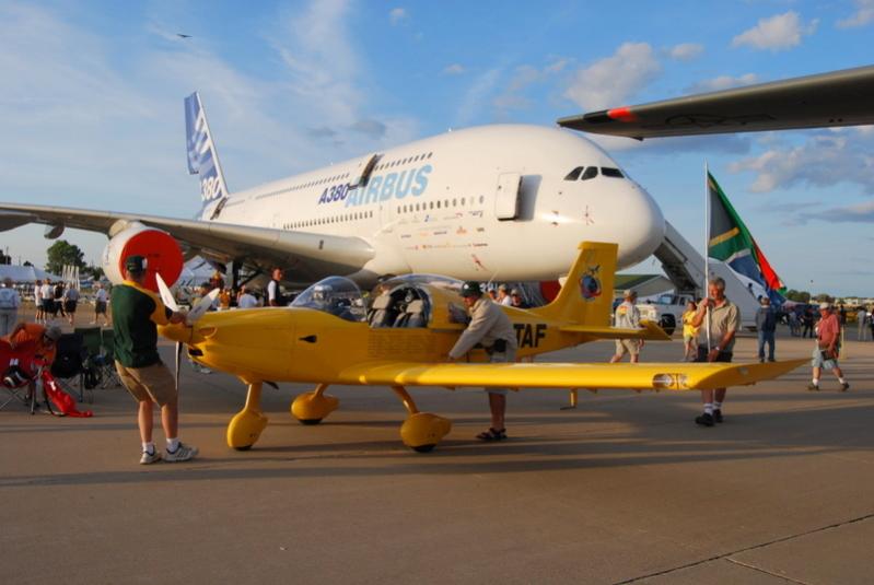

Spin Posted December 8, 2010 Posted December 8, 2010 Jack, I reckon you're coming at this from the wrong angle - there is nothing very rational about aircraft ownership for the majority of people, it is emotionally driven and I suspect that the decision making process re configuration is no different (tongue lodged firmly in cheek) As to the Sling, I've been keeping a close eye on developments - seems to me the manufacturers are being quite conservative in their marketing, for example they are being quite choosy about overseas agents which will probably serve them well in the long run. If they can deliver on pricing and performance I think they have a winner. Back to the emotion thing again - the D6 Sling "just looks right" imo. Cheers Carl Photo from Oshkosh during the round the world flight
Jack Tyler Posted December 8, 2010 Author Posted December 8, 2010 Thanks for that, Carl...and I agree re: your observation about the Sling. I was very impressed by their choice to immediately begin extensive and unmandated testing of production unit #1 right after it finished flying around the world, when they could instead have leaped into production mode while their publicity was fresh. And I *very* much agree with your other observation about the Sling: it really does look 'just right'. Unlike some low-wings with their bubble canopies that remind me of the Sunday comics. (Oops, I didn't say that out loud, did I?) Re: my initial Q (and despite its overly rational nature): I'm not asking why people choose the planes they do. My Q is about what significant design feature(s) distinguish one from the other, either for the builder or the pilot. This of course could be just one big snipe hunt (aka: fruitless search) and there is no significant functional difference. Just doesn't strike me as a logical conclusion to draw, however, given how distinctly different one is from the other. Do CFI's in Oz make their students wear hats when in the cockpit, just like in the other schools? Just wondering... Jack
