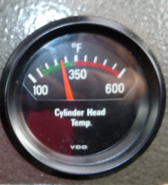

Guest trevoratbay Posted December 17, 2010 Posted December 17, 2010 Hi out there in Jabiru land I have a J200 6cyl with the old heads all going ok at the moment, and have been asking around about cyl head temps almost everyone Ive spoken to said their engine runs cool enough but nobody has given me numbers so I have taken a shot of my temp gauge for everyone to see and maybe comment on, [ATTACH]12693.vB[/ATTACH]the gauge is on No6 cyl the hottest, my oil temp is around 75 - 80 C I think this is because of my positek oil cooler
cherk Posted December 17, 2010 Posted December 17, 2010 g'day treveratbay, I'd be pretty satisfied with that IF it is the cottest ? What is the range over all heads? What does it get to on full power climb out ? I recon oil could be bit cool to burn out condesates if I recall 90∙°c being more the optimum ! apologies for just questions , need more info.
Derby Posted December 19, 2010 Posted December 19, 2010 Hi trevoratbay, My J400 runs about the same on no6 head. My oil temp is about 85 to 95 depending on oat on the day all good i think

JabSP6 Posted December 20, 2010 Posted December 20, 2010 Hi Trevoratbay. The cooler you can get your head temps the better mate. I have fitted an MGL gauge with 6 cht sensors and 6 egt sensors. All reports i have read and experienced myself suggests that no 6 cyl is NOT the hottest cyl. In my SP6 no 3 was about 20-25 degrees hotter and No 4 about 15-20 degrees hotter than no 6. Since fitting the sensors i have spent countless hours modifying the airflow in and out of the engine bay and around the barrels to finally achieve fairly consistant temps across all 6 cyl's. Flying out to work this morning the cht's averaged 120 degress give or take 5 degrees on full power climbout and then cruising at 4500ft my temps reduced to an average of 105 degrees. Before i fitted the MGL gauge my standard cht gauge used to read 140 on climb out and 125 at cruise which i thought was all good until i found that no 3 was 20 - 25 degrees hotter. If you get time i would suggest moving your sensor around to check all cylinders especially no 3 & 4. The biggest killer of these Jab engines is high head temps which causes premature valve guide wear and rocker bush wear, also can cause problems with the valves. Keep a close eye on temps and the lower you can get them the more reliable your motor will become. Wags.
