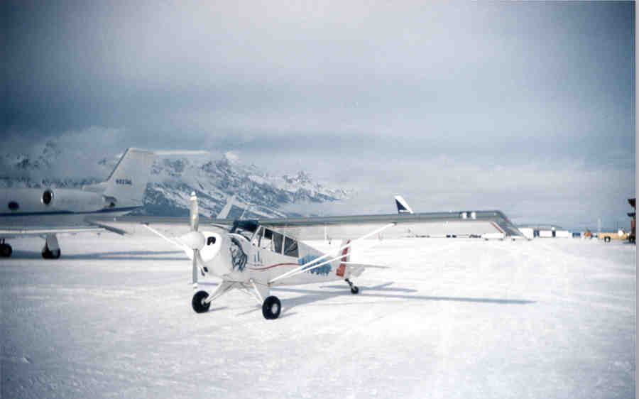

djpacro Posted December 19, 2010 Posted December 19, 2010 Consider the cost of hangarage vs the benfits. At Moorabbin I can totally rebuild my Decathlon airframe every 3 years rather than paying for hangarage for the same time - it will survive maybe 10 times that time outside. Choose a spot with some shelter, point it into the prevailing wind and secure the controls properly etc. A cabin cover is cheap. There are certainly some risks with it being outside - hail and, as mentioned, others leaving it not properly secured. In my experience there is a greater danger of rats and spiders in a hangar than outside. Just as many birds in the hangar as outside. They don't get hangar rash if left outside either. This Husky below was kept outside for many years - from -40 deg C in winter to 30 deg C and lots of UV in summer. Modern fabrics weather very well with the right UV protection, finishes and elbow grease. [ATTACH]12703.vB[/ATTACH] I agree, hangarage is good if you can get it for a reasonable price.
