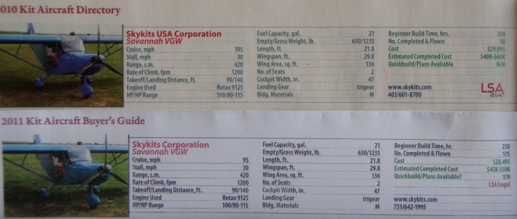

I received my December 2010 copy of Kitplanes magazine from the USA which contains the 2011 kitplanes directory. Something didn't quite look right when I looked at the Savannah XL (known there as the Savannah VGW [W for wide] in North America).
I decided to compare this with the 2010 kitplanes directory found in the December 2009 issue. As you can see from the attached photo, the cruising speed has shrunk by a whopping 10 knots, which is almost 19 km/h! The new cruising speed is now about the same as the Zenith CH-701. I wonder what happened? 034_puzzled.gif.ea6a44583f14fcd2dd8b8f63a724e3de.gif
Another spec that shrunk as well was the build time which reduced from 350 hours to 250: again, you wonder what has changed during the past twelve months for this to occur? :raise_eyebrow:
It was nice to see one figure which increased: the number of XLs "completed and flown" went up by 125 which indicates that a newly completed Savannah XL joins the fleet every three days. 010_chuffed.gif.c2575b31dcd1e7cce10574d86ccb2d9d.gif

A dose of reality maybe? I haven't flown one of the newer generation Savannahs, but I'm always a bit cautious of figures that are noticeably out of line with the competition, ie a stall speed of 30mph suggests that there is a fair wing area and a relatively high lift aerofoil, neither of which are conducive to a high cruise. Bitter experience suggests that there is no such thing as a free lunch 031_loopy.gif.e6c12871a67563904dadc7a0d20945bf.gif. I'd be interested to hear what local owner's experience is - the aircraft is on my shortlist for when I eventually buy an RA type. Of course it is also possible that someone put a mix of mph and kts figures into the directory.
This same discussion raged after one of our members flew a fairly speedy Aussie design and was prepared to accept a claimed stall speed in the low 20's at face value. Maybe I'm just getting old; but faith is a wonderful thing in it's place, that place isn't aviation and technology however. There are accepted methods of measuring the various performance parameters and I get a wee bit narky when manufacturers deviate from them when publishing performance data, quite possibly for commercial reasons.
It is a great pity that aircraft specifications seem to be written by politicians and used car salesmen.
Now some are design specifications that often do not happen in the real life but I can see why there is a reluctance to change to the real world as some potential purchasers think the difference of 5kg of payload or 2kt of speed are a dealbreaker.
Thus we have range figures such as for one European LSA quoted at 4000rpm with Rotax 100hp, or other same engine high strut braced fixed wing aircraft aircraft with a number of other drag features quoting a cruse speed of 110kt...in a dive from 10000ft? All figures seem to be subject to "fudging"...I even now use a tape to check L, W, and H.
As an importer I am not isolated from this however if you care to view my web site or current mag adds you will see a few changes to the factory (design) specifications based on actual W&B's and flying the aircraft.
If it sounds too good remember it probably is
A matter of trusting the manufacturer :-|
I did a comparison between a close competitor of the Savannah between the 2010 and 2011 kitplane directories, namely the Zenith CH-701. It has had a shrinkage in cruise speed from 98 knots down to 90 knots. Other Zenith aircraft kept the cruise speed the same. It is, as you say Spin, probably a reality check that did this.
The problem I have, if anyone is going to 'invest' serious money in an aircraft, you would like to be properly guided by the specifications furnished by the manufacturer. It's simply a matter of trust, as far as I am concerned.

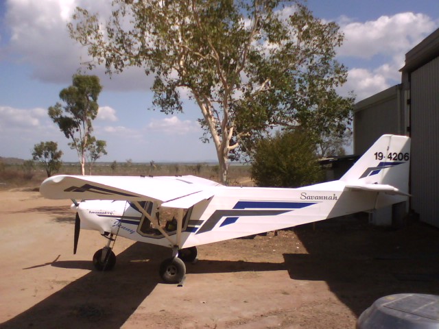

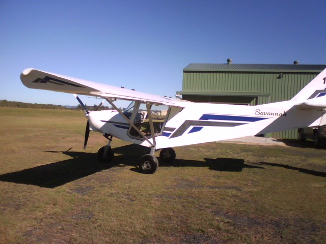

Eightyknots, Don't worry about the cruise on the Savannah, I flew one from Casino to Townsville in 9hrs airtime, which is about the same as I would have done it comfortably in my slicked up 912 100hp standard Lightwing.
Cruise-speed in anything is objective anyway, and is affected by many factors on a given day such as :tailwind, headwind, turbulance etc, etc.
Even the big-money slicked up jobs often have to reduce power, and speed, due to turbulance, and often have to do so quicker because of their small thin wings, with high wing-loadings aand corresponding rough ride.
The Savanah VG does a surprisingly great job at cruise with it's high-lift wing, and really is a mockery to many more expensive machines available today..Ultralighting has never been about blinding speed anyway, if you want to go fast, buy a jet. Most recreational pilots prefer to take time to enjoy the trip, the experience, and the view ! ........................................................................Maj...024_cool.gif.7a88a3168ebd868f5549631161e2b369.gif

So it had to be marketing fluff given that fuel capacity and range did not change but speed did! In truth if there was a fundamental change in cruising speed then range must change as well.

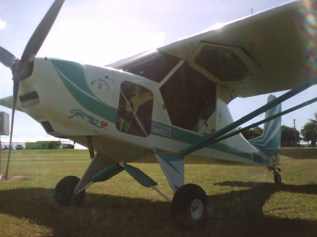

In my Lightwing I am generally happy if I can maintain mid 80s in cruise. Occasionally it'll whip up to low 90s, which I take as cream. It is a big training wing after-all. If there is a good headwind, I have to be content to just stay in the high 70s.
On one leg home from Shute harbor to Townsville, the GPS sat on 99kts all the way !. This ****ed me off after an hour, so I bumped up the rpms 200 and she whipped up to about 104. I have done what I can on my Lightwing to slick it up a bit.
The Savvy VG with the same engine and similiar prop (3 blade Kool Prop), showed similiar numbers as I recall, except that with the Savvy you had to reduce a bit, and slow down more ofter in turbulance, with the high-lift wing due to the rough ride. The Lightwing wasn't so affected. The operating speed range on the Savvy is very impressive though, and something the big fast stuff can't, and won't match, especially the over the fence speed.
My 912 100hp Lightwing spins a three-blade Powerfin prop, which I have pitched for cruise as that's where it spends most of it's time. I only turn about 5200 full power at take off, but still gets 800-1000FPM climb, fully loaded. My Savvy figures are for the standard VG.100hp, the XL or S may even be better.The Kool prop was pretty smooth and efficient, and the tundra tires didn't seem to impact cruise speed as much as expected, but are certainly worth having come landing time !...............................................Maj...024_cool.gif.7a88a3168ebd868f5549631161e2b369.gif
