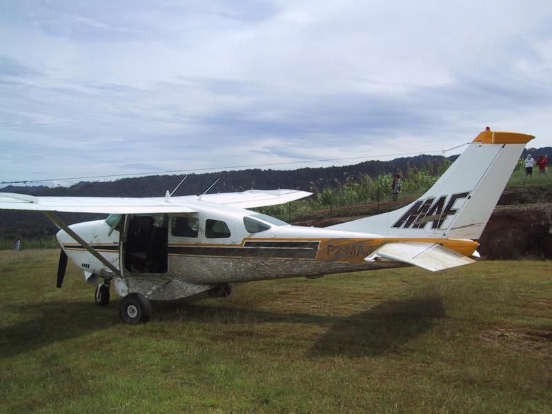

It's a question of how soft. Yes, a t/w will help because you have the CG further rearward when taxiing - but it still needs lots of [ATTACH]12879.vB[/ATTACH]backstick to hold the tail down. Doing this gives your tailplane a real bath of mud as well. If you do dig the mainwheels in with a t/w - you'll go 'a-over-t' spectacularly. 3 pointers with power on and full flap are the safest - wheelers not recommended. MAF do it well around PNG, Irian Jaya and other wild parts of the world.

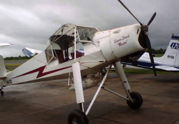

Additionally I don't really like good brakes on taildraggers, except for the Slepcev Storch, where they are a must for directional control right after landing, because of the rediculous low landing speeds,(especially on pavement ). The Storch by the way, is unique in that the main gear is about 1 foot further foward than normal (by design). This makes the tail very heavy, so that full braking can be used as soon as all wheels are on the ground for super-short pull up, without the risk of nosing over. And the Storch does have good brakes !.

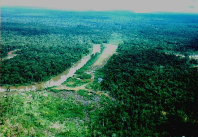

[ATTACH]12886.vB[/ATTACH]
On these strips we left full flap extended to taxy,(C185's), as it helped to keep some weight off the wheels. We also used lower pressures in the 800 tyres - about 15-18 psi if I remember correctly. Due to the heavy loadings - it was usual to have the CG well aft, making it less likely you'd noseover. Braking was near useless - so aerodynamic 'braking' is the essential.
happy days,
546583505_PNGKuritypicalcoastaljunglestripinFlyRprovince.jpg.e2471e0c7432444694e6221ee6e8966b.jpg
