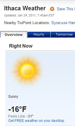

Guest markfnkl Posted January 24, 2011 Posted January 24, 2011 Thanks, FactHunter and JabSP. You both mentioned the jet size, and you may be onto something. In fact, a while back I did have the jet size decreased because I was burning more than the reported normal GPH. My fuel burn did improve significantly, but perhaps it is causing the current problem. By the way, the temperature here as I write this is . . . -26C!![ATTACH]12947.vB[/ATTACH]

Relfy Posted January 24, 2011 Posted January 24, 2011 the -26c is chilly but the 'feels like -31f' (-35c) listed at the bottom is downright scary! As FH said, the lean burn jets etc on the jab motor are the cause of a lot of other problems down the track.
