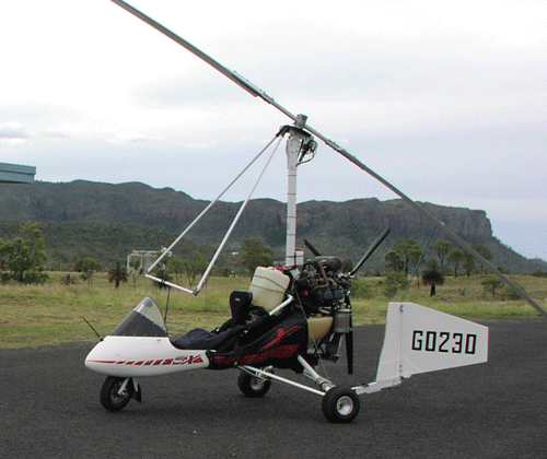

AzharFly Posted March 10, 2007 Author Posted March 10, 2007 Time to be SHOCKED!!! Hi Earlier in this thread I was asking about placing a local wing on a European trike to save considerable money without affecting safety or performance etc. The answer was most definitely not! But wait..... Look what some chap has done to his Airborne Edge.... Now this is radical. I don't think RAAus would want to know this aircraft for sure! Azhar

eastmeg2 Posted March 14, 2007 Posted March 14, 2007 Couldn't help but notice that the AIrborne Edge X trike base in post#10 converted to a gyro also has what appears to be a Rotax-912 donk fitted. That and a larger fuel tank have been the dream of many an Edge X trike owner. I myself given in to Airborne's marketing and am updating.
