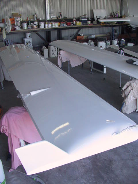

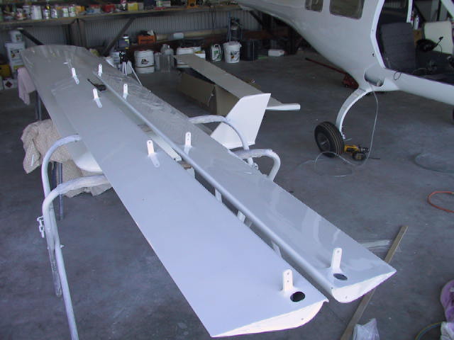

Both wings are sprayed. That took a little longer than expected as the booth was booked by some other selfish bastard, then my spraying expert got sick, then it rained for 2 weekends straight (which hasn't happened here for 5 or 6 years). Anyway they are done and look like this: [ATTACH]2150[/ATTACH]
Ailerons and flaps are also finish sprayed: [ATTACH]2151[/ATTACH]
So are most of the other smaller fittings: [ATTACH]2152[/ATTACH]

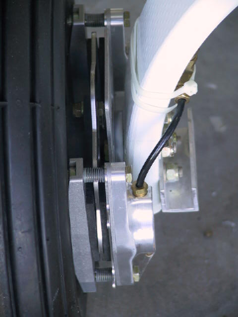

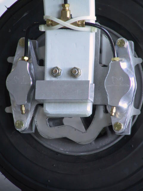

Brakes are also done after a bit of dinking around with the removeable pad system: [ATTACH]2153[/ATTACH] [ATTACH]2154[/ATTACH]

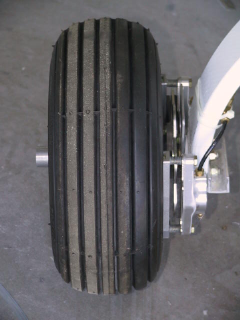

How do you like the crown on these 10 ply tyres Brent? Bit better than the flat-top 6 plys? [ATTACH]2155[/ATTACH]

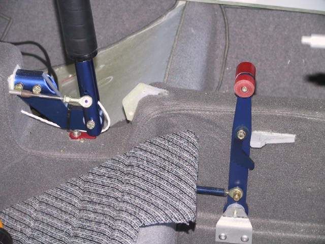

Inside final fit-up is also progressing: [ATTACH]2162[/ATTACH]

You certainly wont be disappointed with those beefcake tyres. We have had a set on for sometime now and they havent worn at all.

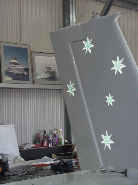

Almost have the artwork done .... hope to have pics of the finished thing later this week.
In the meantime, this arvo it looked like this:[ATTACH]2298[/ATTACH] [ATTACH]2299[/ATTACH]

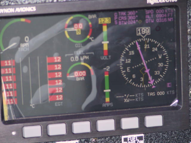

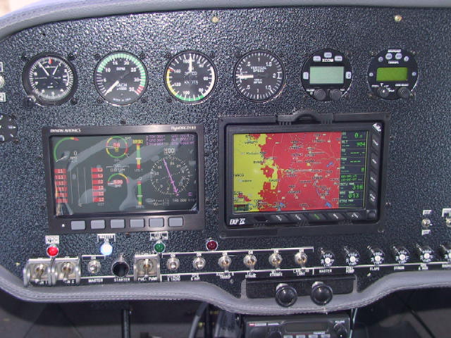

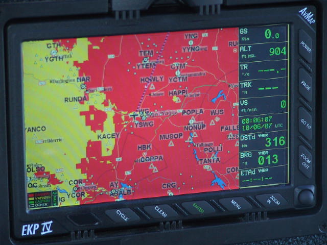

Also got the AvMap back last Friday. It has been fitted with the TAWS and the latest version of the mapping software, and I am WRAPPED. The zoom is now far improved and so is the street and town mapping in the underlying maps.
If any of you blokes or blokettes are looking for a moving map display I would urge you to do a detailed comparison of the AvMap with a 296. The extra screen area is a boon (I reckon).
The AvMap is now installed and is talking to the Dynon so that the HSI is fully operational and it'll do fuel calcs based on route and fuel flow data ..... see the following pics. [ATTACH]2294[/ATTACH] [ATTACH]2295[/ATTACH] [ATTACH]2296[/ATTACH] [ATTACH]2297[/ATTACH]
Ian ........ has yours had the update yet? If not, get it done quick sticks.

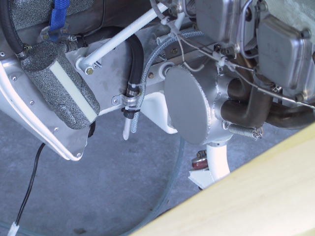

Have also made substantial progress on the fuel system.

Could you let me know where did you get those tyres please.

I got mine from M & C Tyres, who have advertised in recent RAA Magazines.
The tyres were Trelleborg 10 ply aviation tyres and their contact number is 03 5447 1377.
M & C tell me that they are shipping these tyres all over the country and the reports that I have from others show good results, both for wear and puncture improvements.
Roger has a set on his 230 and they are happy with the result so far.

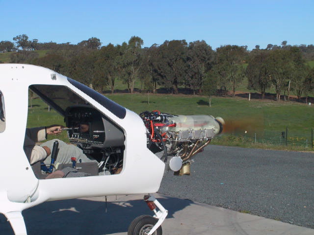

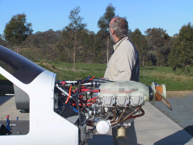

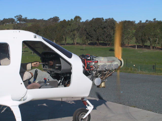

1st engine run.
No worries Ross.
I've flown another 160 with 10 plys and it felt great. Based on the discussion on another thread, the extra crown on the nose wheel does their ground handling a power of good.

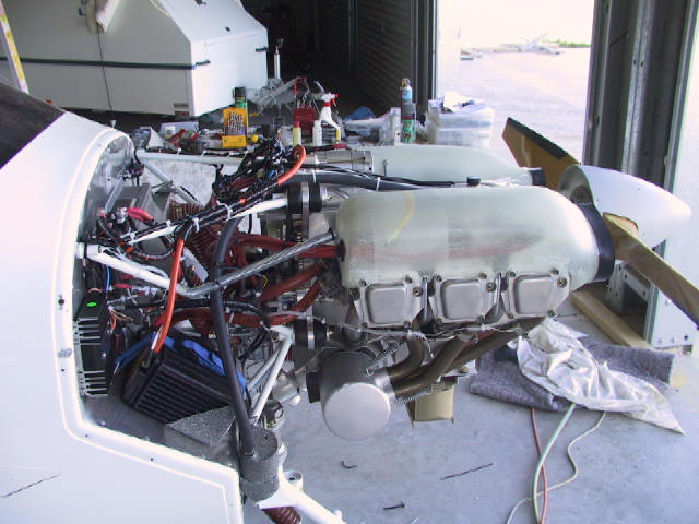

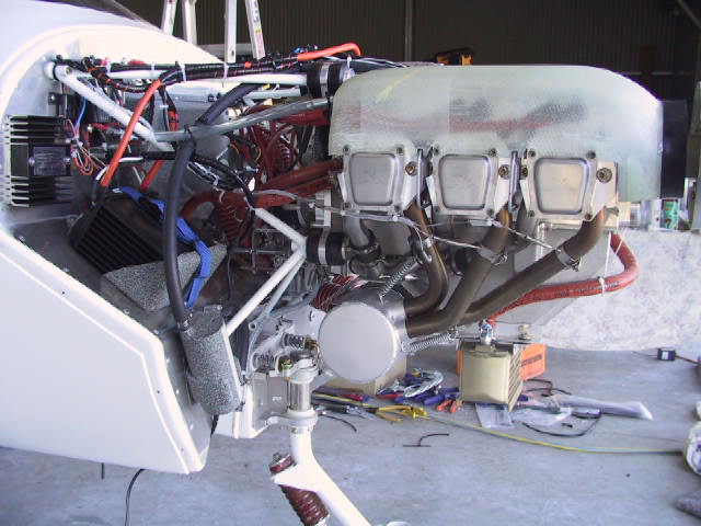

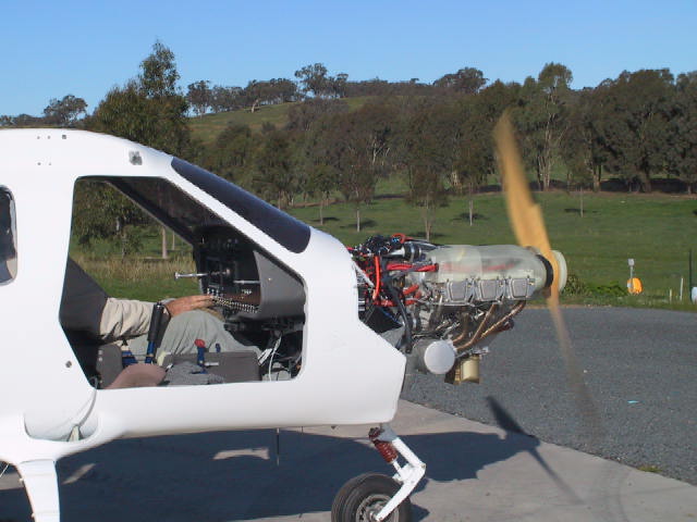

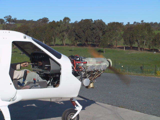

Bit of a milestone here today.
Have commissioned all aspects of the interior fuel system, have the brakes all bled, and have done a 1st engine start.
Sorry about the 4 pics of much the same thing but I'm pretty happy.
[ATTACH]2326[/ATTACH] [ATTACH]2327[/ATTACH] [ATTACH]2328[/ATTACH] [ATTACH]2329[/ATTACH]
It fired 1st time with full choke and after a short run and a stop to check for leaks, it then fired immediately without choke each time.
No fuel leaks, no oil leaks and nothing fell off, + the engine just purrrrrred each time it was run. Can't do better than that.
Then another 230 flew over just while I was checking for leaks. Is that an omen?
[ATTACH]2331[/ATTACH]
Wasn't you spying, was it Roger?
Now need to close up the clearance to the tacho sensor and continue on, so back to the shed ........... but I just had to post this before having a cuppa to celebrate.
Regards Geoff

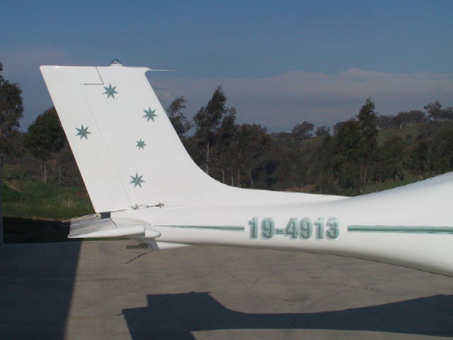

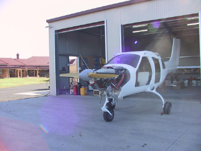

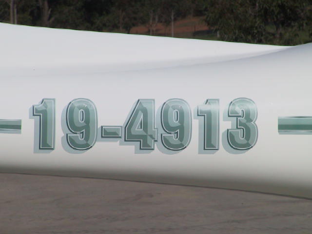

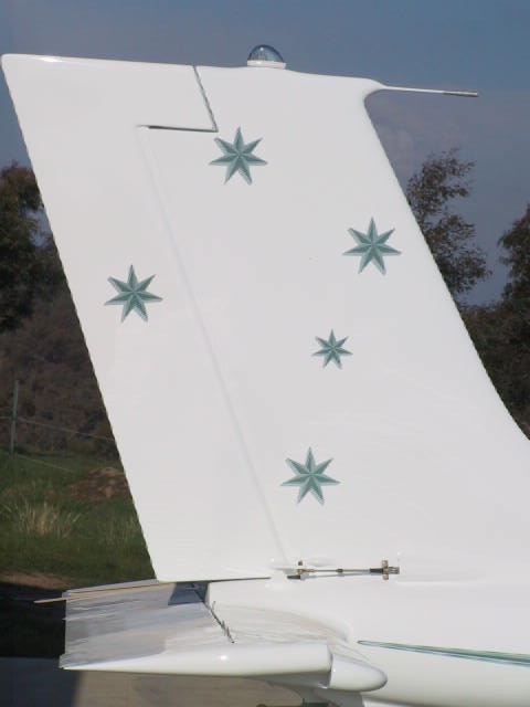

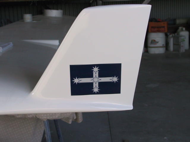

Graphics & other progress
Dear All,
Graphics have finally been added with some minor additions still to come in the next short while.
It's more plain than many, but that's just me.
Am also slowly progressing the balance of the work as time allows, and as you can see I'm still mucking about today with the set-up of the trim mechanism.
Regards Geoff

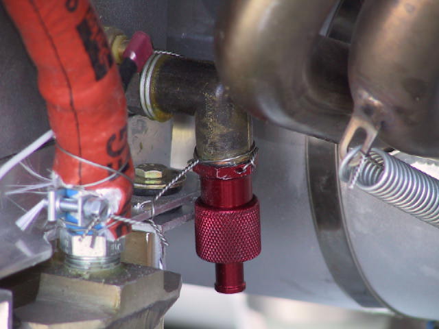

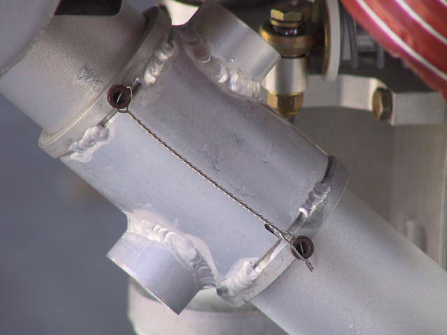

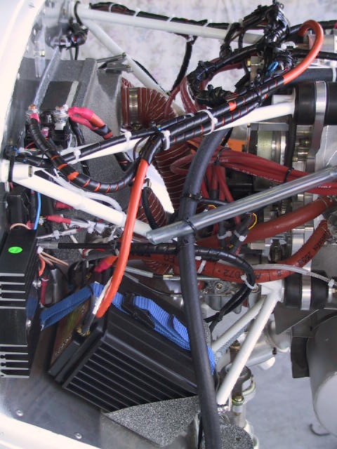

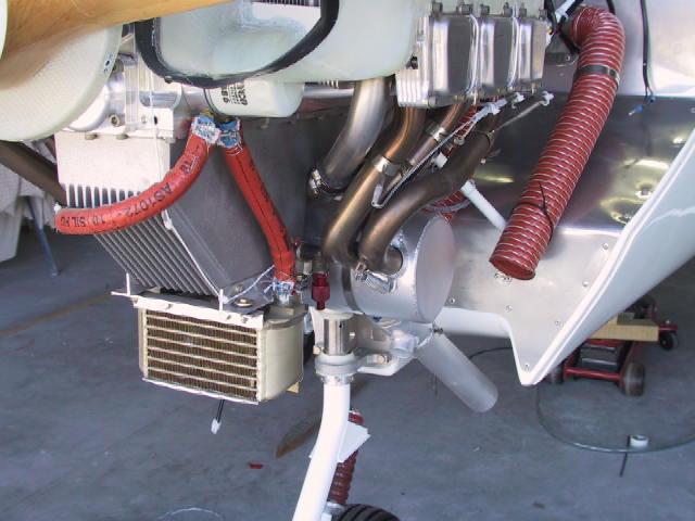

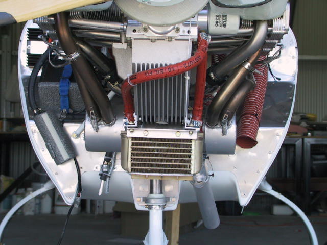

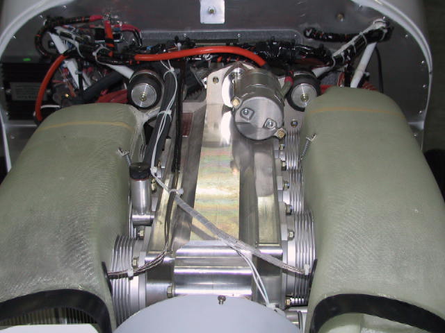

Following is an update to the thread. Mainly just checking stuff and doing a bit of finishing off.

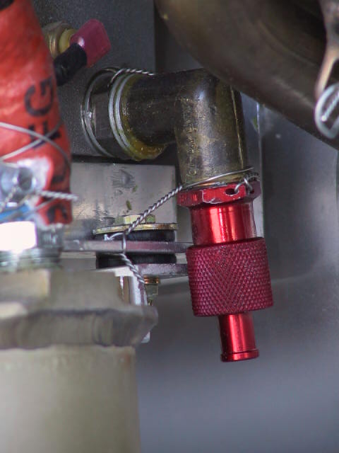

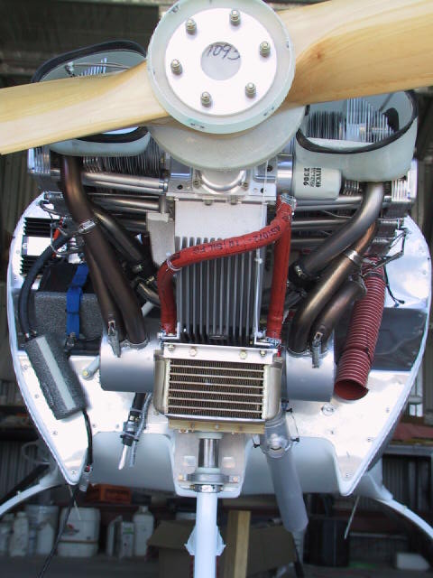

For anyone with a 3300 you will see in post #90 of this thread that the Saf-Air oil drain was too close to the exhaust, and a photo at that time. Well below is the mod developed by/with the YNAR Aviation syndicate (thanks Ian & Roger) and it looks good now.
[ATTACH]3363.vB[/ATTACH] [ATTACH]3364.vB[/ATTACH] [ATTACH]3365.vB[/ATTACH]

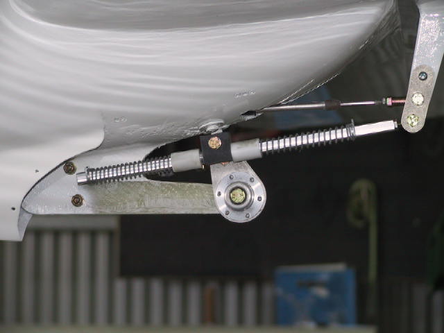

Have the trim and elevator mechanism & cables all done and to spec. [ATTACH]3367.vB[/ATTACH]

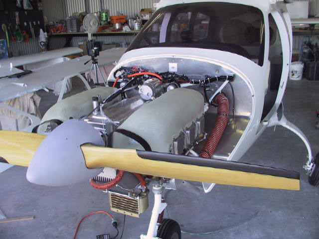

Cabin-heat "muff" (I love that word) installed. [ATTACH]3366.vB[/ATTACH]

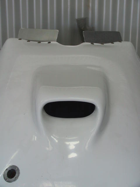

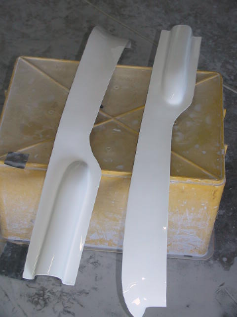

Lower cowl cooling/extraction baffles made & installed. [ATTACH]3368.vB[/ATTACH]

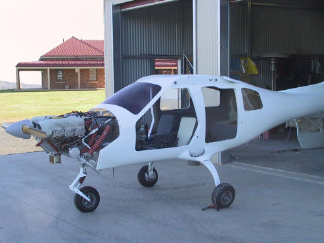

And a few other general shots FYI.
[ATTACH]3370.vB[/ATTACH] [ATTACH]3371.vB[/ATTACH] [ATTACH]3372.vB[/ATTACH]
[ATTACH]3369.vB[/ATTACH]

Hi, Please be aware of the following requirement/good idea [Fire sleeve ends must be "end dipped" to prevent fuel or oil from wicking into the fibers. The end dip is p/n 5027 from Stratoflex or AE13702-003 by Aeroquip
The fire sleeve must cover all the hose and more than 2/3 of the fitting. None of the rubber hose can be exposed.
For push-on fittings the clamp on the hose must be flat to allow the firesleeve to cover the end of the hose. A gear, pinch or screw clamp is not suitable. "AQP Socketless" hose from Aeroquip (automotive high performance division) does not require or allow a clamp. As suitable flat clamps are hard to find you may have to use a crimped or "field attachable" multi-piece fitting.
The clamp on the outside of the firesleeve must be steel or stainless steel, no plastic allowed.
Clamps of this type are available from:
Oekter http://www.oetiker.com
Band-it http://www.band-it-idex.com
The firewall must be sealed and all opening to the cockpit (rubber/non-steel grommets for the wires and control cables) must be protected with stainless steel covers to prevent fire passage into the cockpit.
The hose end fittings should be steel or stainless steel.
] Cheers
