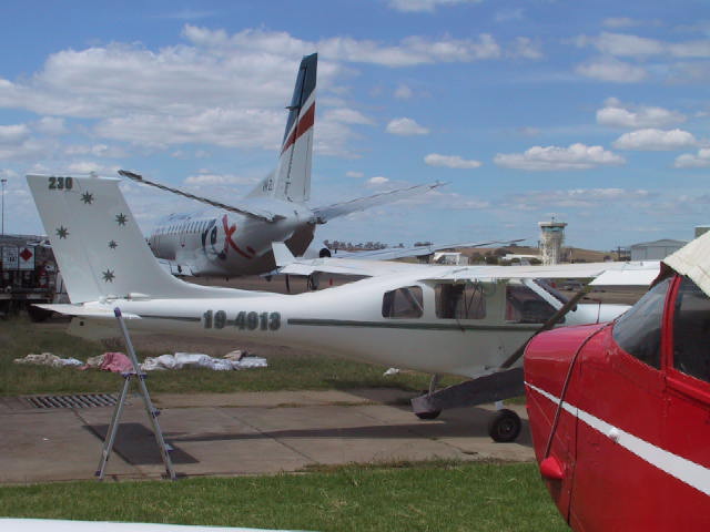

The photo taken at the airport, looking under a wing, is the wing a Kingair or similar? it looks like it has been left abandoned in the grass!
Cheers Guy
  • Replies 342
G'day Guy
Still have the Jamestown shindig (or is it a knees-up?) in the diary, so look forward to having a chat face-to-face. Am also trying to find out more about that strip at Mallala, so I can drop into the Aussie Superbike round too that weekend.
But before that, are you blokes coming over to Natfly?
That photo shows one of REX's Saabs which has been pushed back there. Not sure how long it has been there, but the grass is growing while you look at it here, after the 1st decent rains (over a couple of weeks) in years.

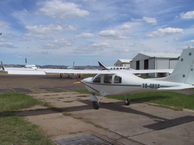

But final assembly & inspections went well Monday and yesterday. [ATTACH]5036.vB[/ATTACH] [ATTACH]5037.vB[/ATTACH]
Weight and Balance has been done today and CG calcs all look good although she is a tad heavier than some due to the paint prep and instrumentation. I've started a diet today to cancel that out.
[ATTACH]5038.vB[/ATTACH]
Hopefully we will get fuel tank calibration and final compass calibrations completed tomorrow, and be able to knock over the paperwork soon.

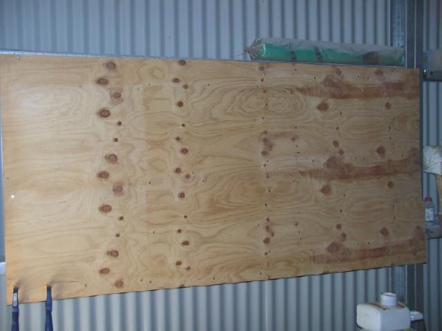

I was cleaning up the shed late last week ......... and for all of you budding or present kitbuilders, you have no idea (or maybe you do know) how satisfying it is to see the parts board looking like this.
[ATTACH]5069.vB[/ATTACH]

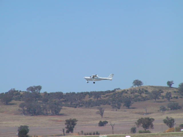

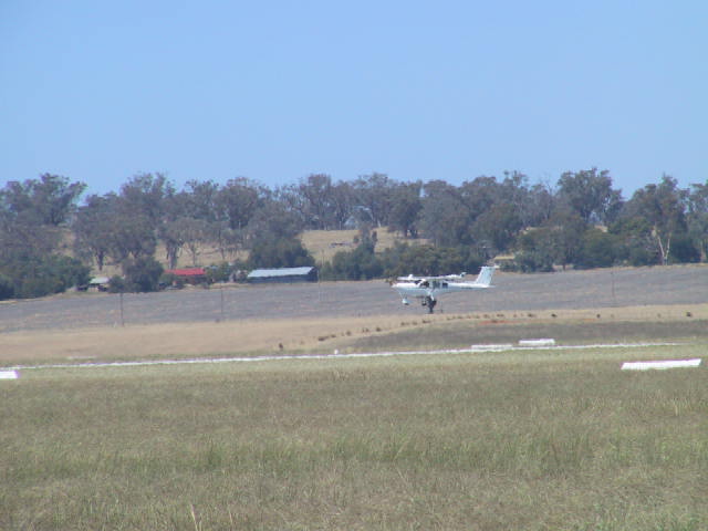

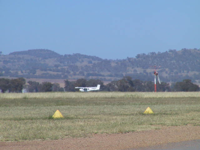

And she is flying. [ATTACH]5071.vB[/ATTACH] [ATTACH]5072.vB[/ATTACH] [ATTACH]5073.vB[/ATTACH]
Fred did 45 minutes of testing, then gave her the thumbs up and handed her over to me. We didn't need to make any adjustments to any controls and everything is working perfectly. [ATTACH]5074.vB[/ATTACH]
I then did 1.5 hours around the district and am pretty happy as she flies beautifully.
Will go out again for another flight this evening.
Bugger me, this is good fun.
