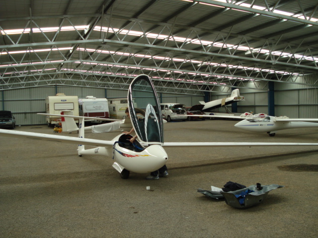

Well the Sailplane is done and goes tah-tahs to Corowa tomorrow where it will live all this summer.
That frees up 2 bays inthe shed for J230 stuff to be spread out ..... and if I keep spending like I have been, I'll be living over there too.

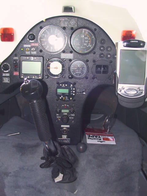

For those who are interested, here is what the dash of a late model sailplane, with an engine, looks like.
Fitted the latest OzFlarm anti collision display today ... at top centre.
Also for those of you with a GPS and a PDA, check out www.winpilot.com if youare interested ina relatively low cost moving map display. They have both Gliding and VFR Power programs and it works very well in my machine.

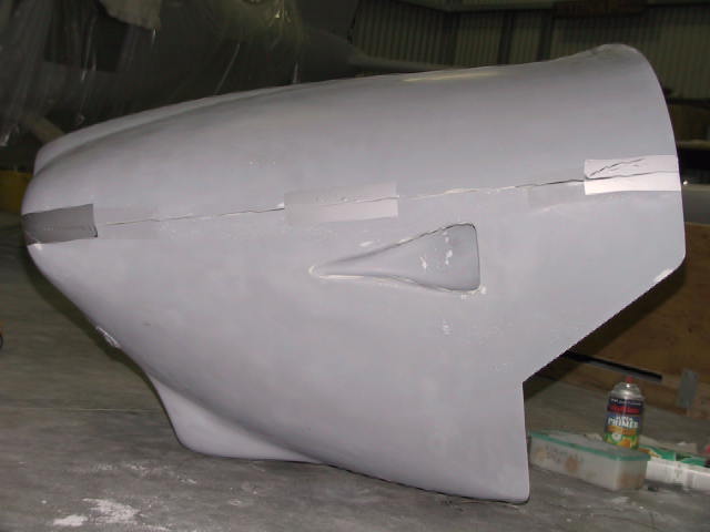

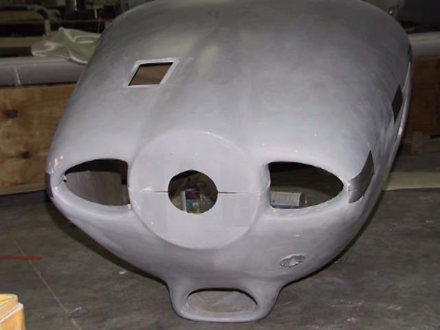

Can't believe it's been so long since my last post, but have been locked in combat with the top & bottom engine cowls.
I have found this to be the most difficult part of the build so far ... mainly because I haven't done it before, am being over pedantic about getting it right .... and it's bloody hard to get it all spot on.
The front needs to be central on the prop shaft, the back needs to fit into the joggle on the fusl*ge and the sides have to meet up in a piano hinge. Doesn't sound too bad, does it? Except that when you adjust one area all of the others move as well.
I've been ringing and emailing all that are giving me guidance, then I sit and look at it all for a while ... then make another adjustment. Then sit for a while and swear.
Part of the past 11 days was also taken up with some work, too, whichdistracted me from aviation for a while. It's a bugger like that, isn't it?
Well ... for the good news.
1 The 1st headset has arrived and they are yummy. See pic below.
2 My Glider is at it's new home for this soaring season and the Form 2 annual is complete. That's yummy too. See pic.
Then see the pics of the Cowl when initially taped together. That's the easy bit.

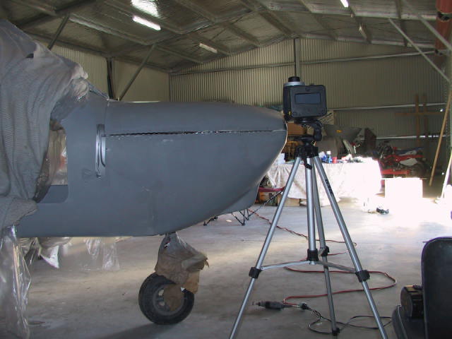

Then see them on the aircraft as of today .... ready for more adjustment and hopefully for trimming & final fit tomorrow. Don't worry about the fact that the piano hinges aren't together, as thy should all come together nicely once all is trimmed and fitting into the joggle ... I bloody-well hope so, anyway.
Have also fitted a SAF-Air oil drain unit and it is pretty close to the exhaust. I wonder if the new extractors are closer than before and am waiting for a reply from someone else who also has one on a previous model3300.
Regards & if any of you have an easy procedure for the cowls (other than buying a factory aircraft) please let me know before I start trimming them tomorrow.

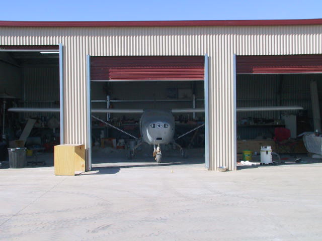

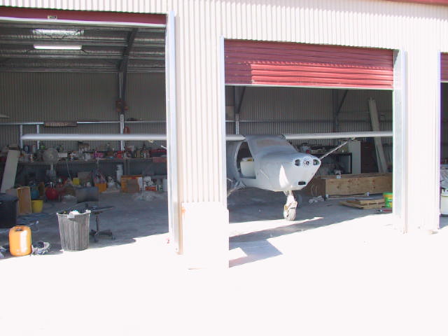

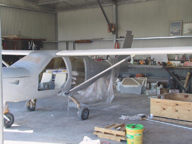

Have done a 1st trial wing fit and all looks good. Geez the 230 wing makes them wide buggers, as you can see from the following pics.
I just about have the cowl beaten,with just a fiddle or two to go before final attachment of screws and camlocks.

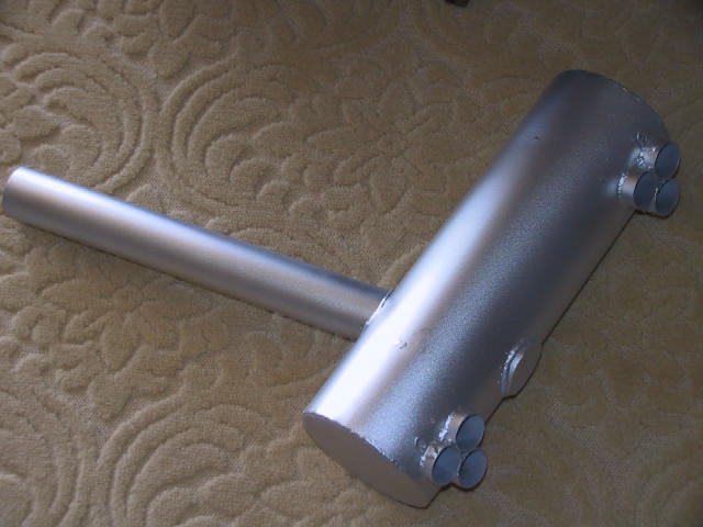

Also on here is a pic of the ceramic coated muffler and tail pipe by Jet-Hot Coatings. They did a nice job& I meant to post this a week or two ago.
Now onward and upward to finish the cowl, bond on the strut/undercarriage fairings, and complete the wings.
Cheers Geoff

[ATTACH]229[/ATTACH]
I think I can see a potential problem here. 068_angry.gif.cc43c1d4bb0cee77bfbafb87fd434239.gif
No Peter it's OK. The shed is expendable.

G'day All, [ATTACH]230[/ATTACH]
Is it just me or does that look like a cessna 307? you know, the pusher puller twin aircraft with the twin tail booms??
now that would look different, a twin tail boom Jabiru, Vampire style!
Guest sypkens
Captain,
Can I ask a stupid question? :confused: How will you get it out of the hanger/shed? Does the wings detach?
Regards,
Jan
No probs with that question Jan if you haven't built or studied a Jabiru.
What is shown in the pics is just the 1st trial fit of the wings. Each wing has 2 bolts attaching to brackets that are molded into the fuselage and then there is a bolt at each end of the struts.
I just have the bolts thrueach hole at this stage and it's a 30 second job to take the wings on and off as I progress the build.
