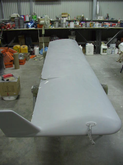

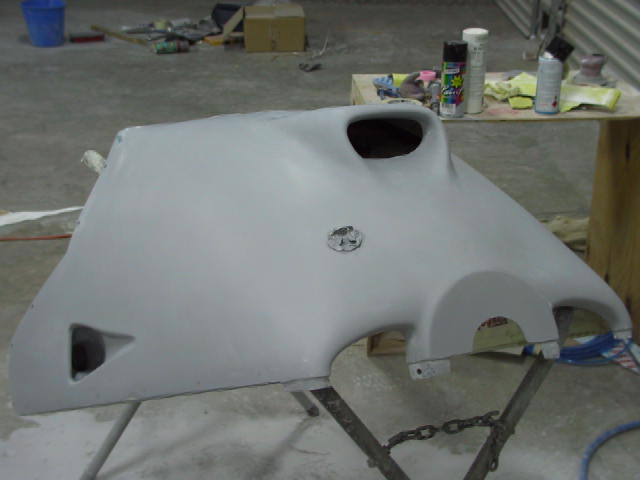

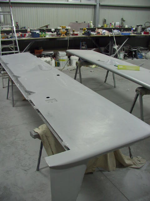

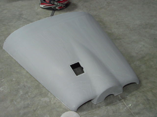

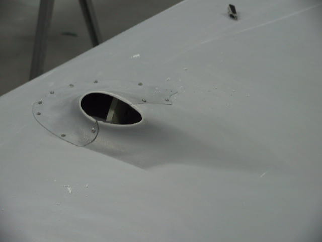

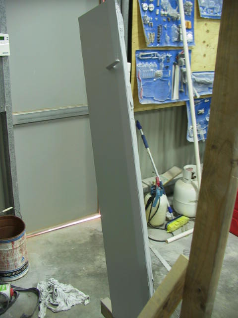

The wings & cowls were due to be sprayed over this weekend however the failure of the overload switch on my compressor late last week has delayed that by a week as the booth is not available next until then.

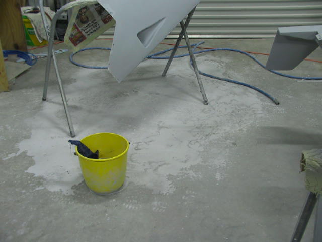

Gave the wings & cowls a final bog touch up & a wet rub with 450 today and will hit them with 600 for the final wet rub in the next day or so.
[ATTACH]1181[/ATTACH] [ATTACH]1182[/ATTACH] [ATTACH]1183[/ATTACH] [ATTACH]1184[/ATTACH] [ATTACH]1185[/ATTACH]
Wind has been blowing like crazy so did all of that inside ... and boy does wet rubbing make a mess.

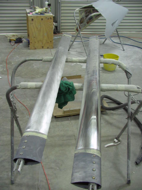

Have also given the strutts a sand/polish progressively with 600/1000/1500 and they are just about ready for a polish before the final coating.
[ATTACH]1187[/ATTACH]

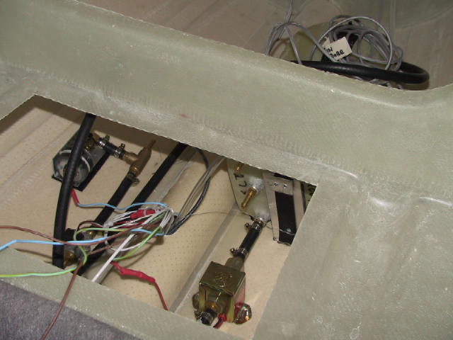

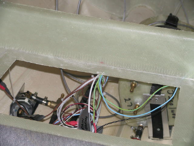

Fuel system inside the fuselage is just about complete.
[ATTACH]1188[/ATTACH] [ATTACH]1189[/ATTACH]

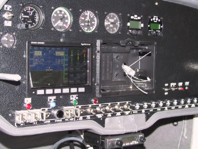

Panel is in ... see attached photo.
So is the battery, so hope to light it up in the next day or 2.

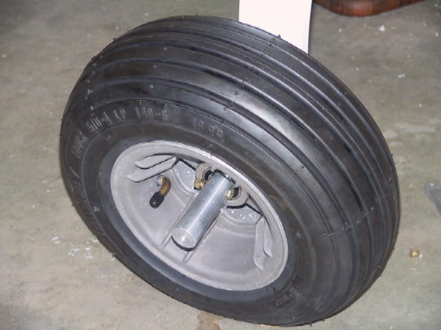

Have fitted 10 ply tyres (see pic) sourced from M&C Tyres who advertise in the RAA Mag. M&C were very easy to deal with. [ATTACH]1741[/ATTACH] The 10 ply units are well made, have a deeper tread pattern, are a tad more but not too much heavier and are hopefully cathead proof. You need some Ian, after your experience at Narromine.

All other circuits in the dash have been commissioned and after a disproportionate amount of time sorting out the blue Master LED, all is working well.
Have installed one of Claus's solid state Landing Light flasher units and it works a treat.

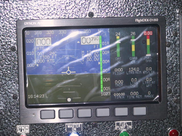

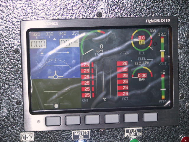

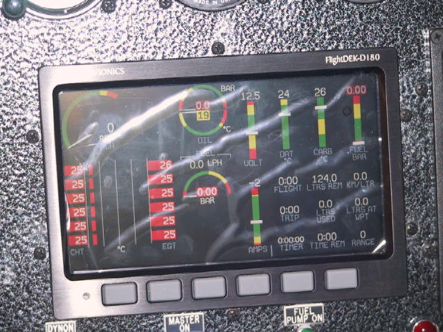

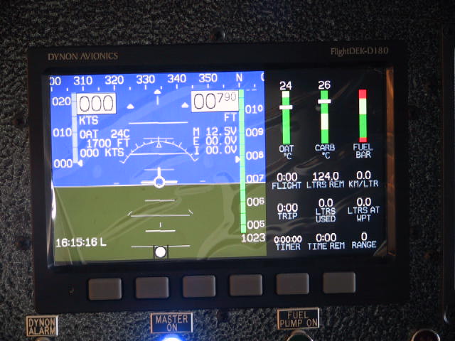

Following are some pics from 3 or 4 of the Dynon screen. Finally got the carb temp sorted after fitting the wrong resistor. The Dynon Forum on their website for problem solving worked well on that and Dynon's response to my problem was immediate. [ATTACH]1746[/ATTACH] [ATTACH]1742[/ATTACH] [ATTACH]1743[/ATTACH] [ATTACH]1744[/ATTACH] [ATTACH]1745[/ATTACH]
Have almost completed behind the sound curtain where the head tank, fuel pump, fuel flow meter and fuel pressure sender are installed. [ATTACH]1747[/ATTACH]

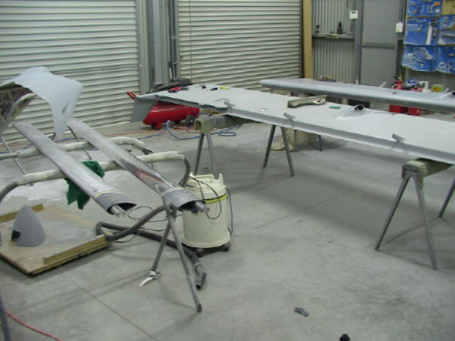

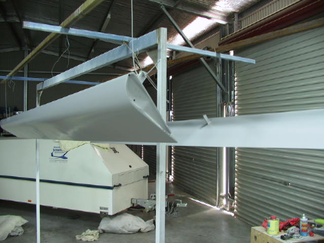

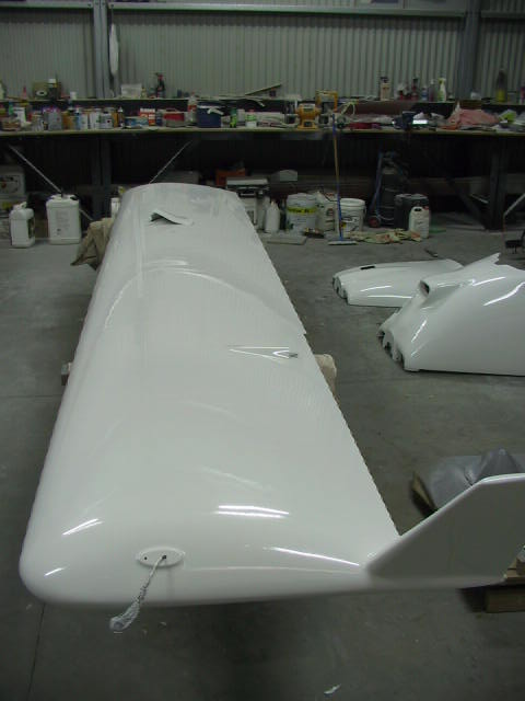

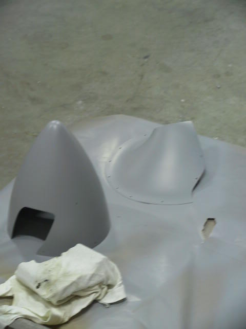

One wing and the top and bottom of the cowl are finish painted. [ATTACH]1749[/ATTACH] [ATTACH]1750[/ATTACH]
Other wing, ailerons and flaps are finish primed and rubbed back for painting next weekend if the booth is available. [ATTACH]1751[/ATTACH] [ATTACH]1752[/ATTACH] [ATTACH]1753[/ATTACH] [ATTACH]1754[/ATTACH]

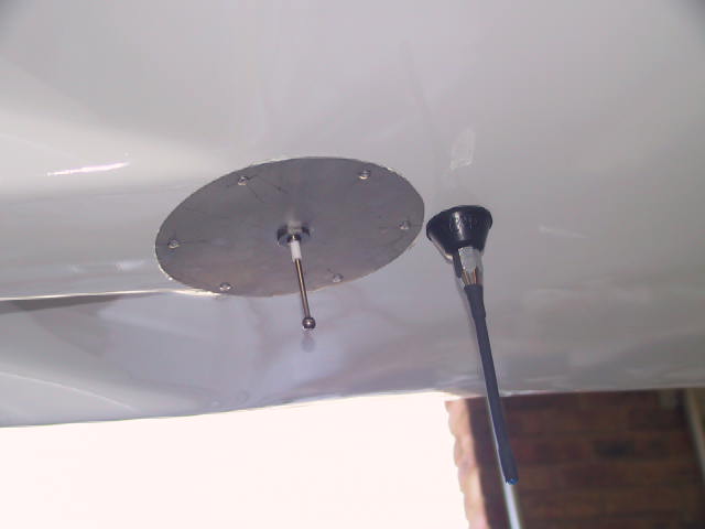

Transponder and UHF antennas are installed and all items commissioned. [ATTACH]1748[/ATTACH]

Have you checked the VSWR on the UHF set? I wonder if it will be OK with regards to a ground plane, obviously I cant measure but it looks like a 1/4 wave antennae and therefore needs a gnd plane?
Andy
Thanks for that Andy.
Yes it is 1/4 wave. The dealer said it would be OK in this configuration, it works fine in a 1st test at 1200 m distance and the installation data says that these don't need to be SWR'd. I have one the same mounted on the headboard of my ute with nothing much below it and it works fine there too. Based on your note I'll test it again at 5 kms + call Mobile One tomorrow and have a chat with them.
Guest Andys@coffs
Geoff
Is the Headboard of your Ute metal? If it is, and its electrically connected to the vehicle earth then it will act as a gnd plane.
The point to make with Mobile one when you talk with them is that the antennae is mounted on fibreglass with no Gnd plane, althought the metal plate that is under the transponder antenna, because of its close proximity to the UHF antenna (which in it self can be an issue) will provide some gnd plane affect. Might be worth sending them a copy of the picture above, may also be worth checking with Microair about any issues of Tx'ing on the UHF with the Antenna very close (a fraction more than 1/4 transponder wavelength) to the transponder Antenna.
Anyway, see what they say. I spent 11yrs as a Radio tech in the RAAF, but that was a few years back now and the only radio / antenna work that I do now is my own.
Andy
