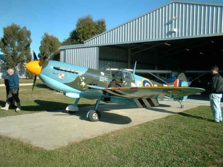

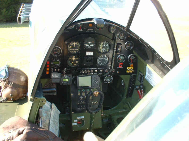

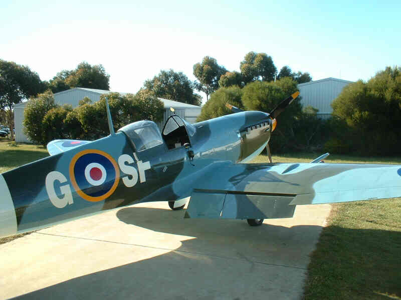

Deskpilot Posted February 13, 2011 Posted February 13, 2011 This is the one I saw at M.B, [ATTACH]13119.vB[/ATTACH] [ATTACH]13120.vB[/ATTACH] [ATTACH]13121.vB[/ATTACH]
dazza 38 Posted February 13, 2011 Posted February 13, 2011 This is the one I saw at M.B,[ATTACH=CONFIG]20406[/ATTACH] [ATTACH=CONFIG]20407[/ATTACH] [ATTACH=CONFIG]20408[/ATTACH] This is the thing, the way I see it.If the replica spitfires can be registered, which by the way are quite within the rules as I see them.If the owner plays by the rules and If they are 90 Kgs and dont take a passenger and only fuel up to the current 544Kg limit, which isnt much at the moment.Every thing is fine.I dont know what the damage has been by videos like "By Anymeans"with the chevy V8, which flew from Watt Bridge to Maryborough via the Glass house mountains .But when i first bought it and my My Missus Kymeille watched it, she pointed it out to me as I was to busy pouring a beer anyway .I was like WTF how can they have that on the video.My missus isnt into flying, but she is a good observer.If she knows it not correct, how many other people know. People always pick on CASA and the RAA but its not rocket science, im sure they have seen this stuff.They have let it go, for what ever reason, im not sure.Maybe they are turning a blind eye for the sake of world piece.lol Actually I shouldnt have quoted the above thread, but I dont want to re-write it.
Deskpilot Posted February 13, 2011 Posted February 13, 2011 That's OK Dazza. I haven't seen the video you're on about but I doubt that all Spit flyers are stupid and arrogant. Yenn, did the Spits manoeuvrings put you in danger? Cheers Richard, I'll have to start thinking seriously, about loosing weight.
