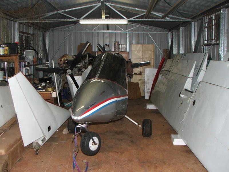

fly_tornado Posted February 13, 2011 Posted February 13, 2011 5Mx10M shed holds my 2 tornados tools and crap [ATTACH]13118.vB[/ATTACH]
