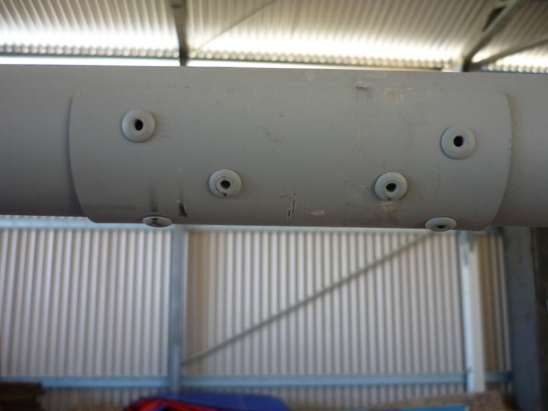

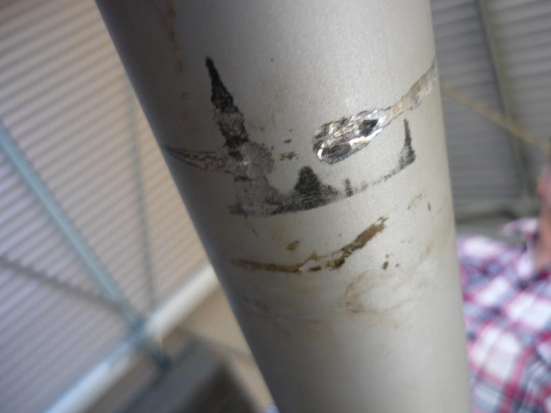

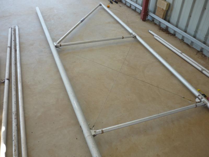

pudestcon Posted February 13, 2011 Posted February 13, 2011 G'day All, This thread is about Thruster wing spars so may not be relevent to some people. Nonetheless, I thought I'd post here as more people will get to read it than if I posted in the Thruster section. I'm interested in getting your views on some wing spar damage I have seen recently. Please check out the photos and give me your thoughts. In particular I'm interested in your views of the spar damage, and whether it is ok (in your view) to continue using these spars on the aircraft, and what you think about the repairs that have been done on both spars. Cheers, Pud

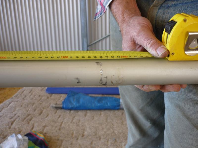

pudestcon Posted February 14, 2011 Author Posted February 14, 2011 :thumb_down: Scrap it !!! Frank. Already done Farri!! It's interesting though, that the spar with the patch "repair" has been on the Gemini for a long time. Not sure what it is hiding yet.... I suspect damage similar to what you see in the other photos. Riley, you must grow big tomatoes. The join in the main spar is definitely in a high stress area, being at the strut connection point, as shown in the 4th photo. FT, a new main spar cost me $290 plus $150 freight to get it to WA. I'm happy to pay that for peace of mind, and to have a wing that is structurally sound. Is there anyone out there who would use these spars, and would care to give me their reasons why? It is obvious someone thought that both these repairs would suffice. Pud

facthunter Posted February 14, 2011 Posted February 14, 2011 Even scratches are a no-no for things like Al tube spars. They are subject to bending loads and cracks can propagate from an imperfection very quickly. The maximum load will be at about the spar attach point. The wing tip areas carry no load by comparison. Nev

icebob Posted February 14, 2011 Posted February 14, 2011 Hi Pud, Like the others said bin the lot, that "repair" is not to the required standard anyway, someone has used the 20/20 rule which only applies to flat stress areas, be it with the wrong type of rivet, ordinary "pop" rivets were used not aircraft grade,it would just add stress into a different area. Photos 1-3, I can see at least six reasons to bin them. Bob.

pudestcon Posted February 14, 2011 Author Posted February 14, 2011 Well that's about 245 hits with about 10 very definite "DO NOT CONTINUE TO USE" replies, and not one view advocating to continue use. I'm happy to report that both trailing edge spars on the Gemini and the leading edge spar on the T500 were replaced before I posted this thread. It was however, worth getting the 'learned forum members' collective view on this, as (as I have said before) someone obviously thought the repairs were structurally sound. Thanks everybody for your thoughts. Oh, by the way; my restored T500 is about a month away from test flying - yeah!!! Pud
