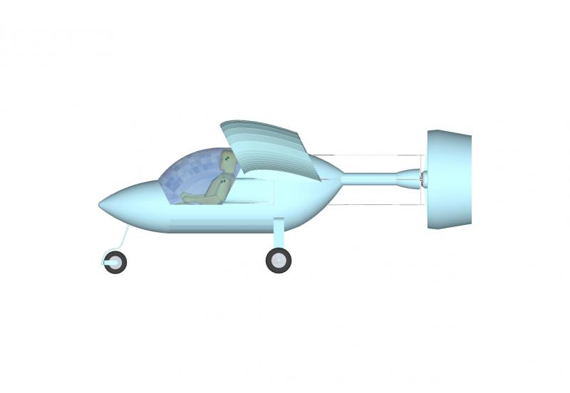

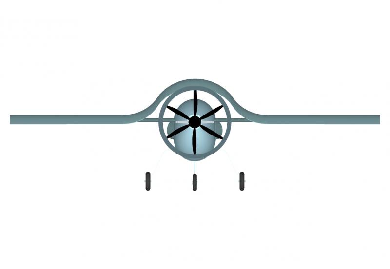

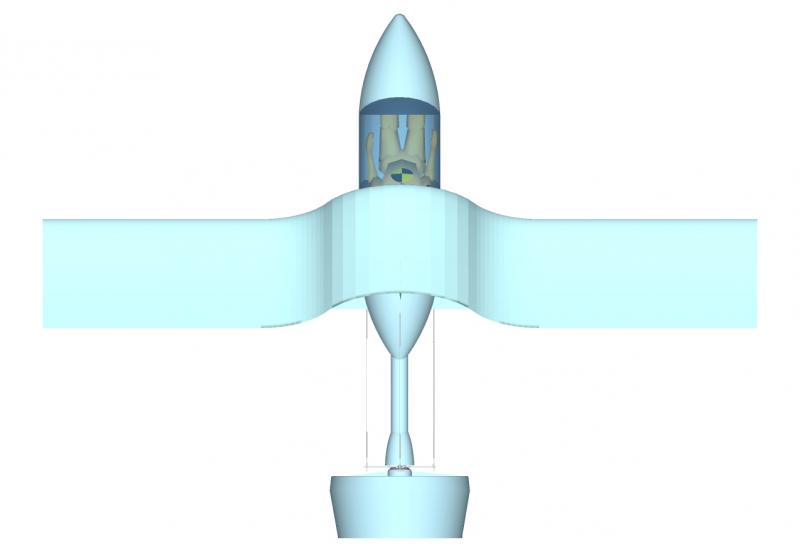

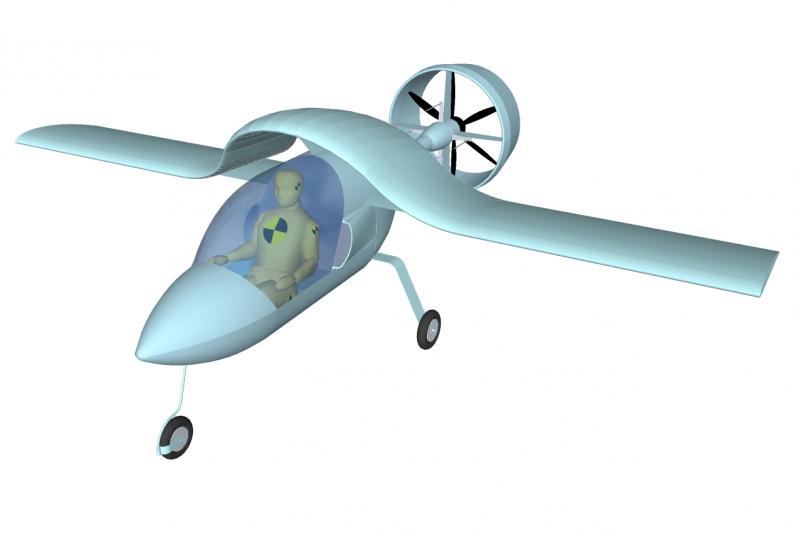

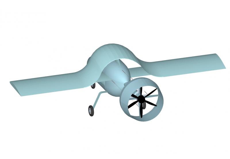

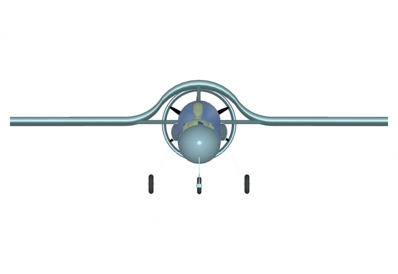

This is a new one for my 'stable'. Something a little different and an update from a older model.
VT (Vectored Thrust) - ICE ( Inverted Chunnel {CHannel/tUNNEL} Experimental.
Why? why not. The channel or tunnel wing was a successful design in it's day but didn't survive due to cost and complexity. I've inverted and modified it to bring the center of lift forward a bit without having the wing tips so far forward that you loose sight of the airstrip in a turn. It will also keep the sun off your bonce at times.
VT? Gotta try something new. As for gyroscopic problems....a pair of contra-rotating props should cancel each other out, and to get get around the 'one engine, one prop argument', it's a single propulsion system on a common shaft.
Nay Sayers will no doubt raise the question of it falling off etc. No more dangerous than a helo or gyro plane. If their 'Jesus nut' comes off..................................

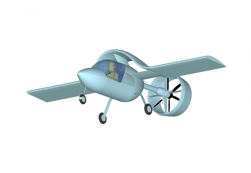

You may also note that my model has finally taken on some nice curves. Amazing what you can learn by reading the rules.
I wonder which part of the wing would stall first?
(I can see some interesting tuft testing coming on, once your plane is complete)
I wonder which part of the wing would stall first?..........
I've no idea mate. It might not even fly. I'm not an aeronautical engineer/designer. Just a dreamer. An interesting question all the same. I might build a model (glider) just to find out. I've a bundle of balsa wood hidden away for years, might as well use it.
As for my contra-rotating props idea, I'm told by my friends across the pond that there will still be gyroscopic forces at play and the effort to actually move the tail assembly would be huge. Looks like I'll have to redesign for a static prop in front of the duct. Get the sizing right and it would work, but not as effectively as if the prop stayed in line with, and moved with, the duct. AH well, back to the drawing board. First problem is to figure out how to mount the tail and connect the controls. My first idea makes the tail awfully heavy. Solution...........anybody?

Two things, the interference between the wing and fuselage would cause a fair bit of drag, and if you study the 'Custer Channel Wing' you will see he derived extra lift not so much from the airflow through the channel, but the pressure difference outside the curved surface trying to get to the low pressure area within, thus causing lift.
Your inverted channel will do just that, lift inverted! (downwards that is).
Now, if you put the wing on the bottom.........
Arthur.
011_clap.gif.c796ec930025ef6b94efb6b089d30b16.gif011_clap.gif.8adfe837b4189ee6622bf4917d6a88c0.gif011_clap.gif.c796ec930025ef6b94efb6b089d30b16.gif Thanks Arthur. I think you'd need a long ladder to get into it.
I've given up on this project due to insufficient knowledge of gyro's (and I was trained on them to some degree) My theory of contra-rotating props for vectored thrust has been shot down yet I was looking at a 'personal helicopter' yesterday where the guy had C/R props on a frame which he tilted for direction control. Seemed to work for him ????
