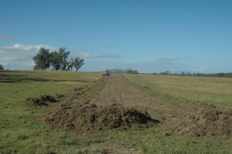

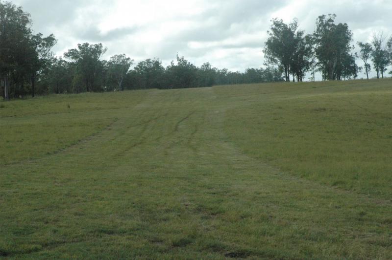

Kyle Communications Posted March 11, 2011 Posted March 11, 2011 I am not sure what the gradient is on my strips but they are noticeably uphill. When the 4 aircraft came in to christen the strip they landed uphill and took off uphill. 2 of savs and 2 of 701...maybe its different for these "stol" aircraft. The attached link goes to the video and you will see none of them had any difficulty taking off uphill with a pretty severe crosswind. The wind was coming from about 70 degrees from the right off the nose at around 20 knots that day. it was the saturday of the Monto flyin so most will remember how bad the wind was that day if you went to the flyin. It was almost crosswind at my strips you can see by the dust trails..the strips had only been dozed about 3 weeks before so it was still mostly dirt.... but they are looking pretty good now :)

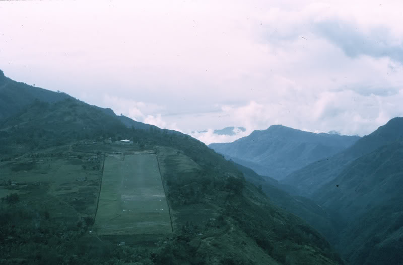

poteroo Posted March 11, 2011 Posted March 11, 2011 1% downhill is worth probably better than 2 kts of headwind..... and, as everyone has noted previously, it's about what the terrain is like on the uphill side. Generally, strips are located on the lower slopes in the landscape - with the terrain rising more steeply above the top end. No chance of outclimbing that! As well, mountain winds can be very flukey. I'd always opt for good old gravity rather than any wind.The pic is Ompkali, EHD of PNG with around 14% uphill slope, and 800m length....if I remember rightly. Here, you added power on landing, even in a 500HP twin. On t/o, your distance to reject was about 100m.I think part of the risk in uphill takeoffs is that you will touch again if the wind drops slightly - and this reduces your acceleration lots more than you might think. The really problematical strips are those without any windsock = inaccurate wind estimations. happy days,[ATTACH]13300.vB[/ATTACH]
