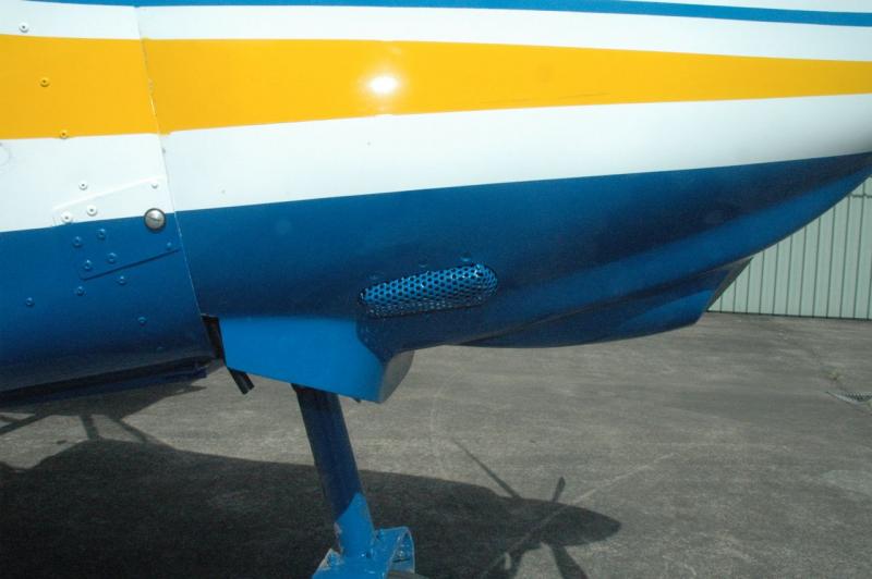

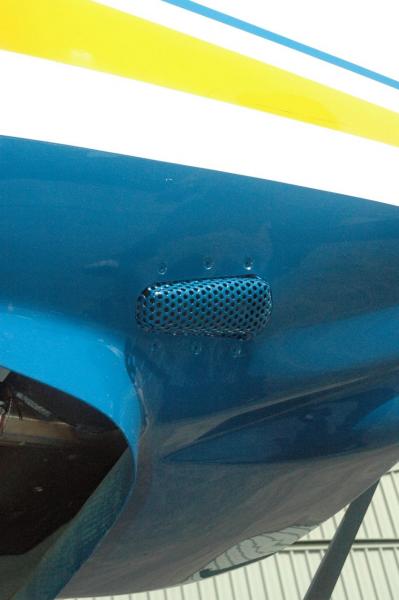

Kyle Communications Posted March 13, 2011 Posted March 13, 2011 Hi John Came across a guy who used to work with you at Philtronic...Peter Davies he said to say hello and wants to catch up with you I can send his email to you if you want. There is also a issue with the exhaust burning through the cowl on the new savs. Laurie Strickland has come up with a great fix for it attached are the pics I took of it. I have seen another new factory built one that has the same issue and this seems to be a great fix and also would get more cool air flow into the cowl. Mark
