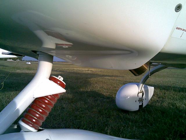

Guest brentc Posted January 30, 2008 Posted January 30, 2008 You might find that your tacho is over-reading (which is fairly common) and you may be running a tad under 2,800 which is warming things up a little so trying 2,900 might help a bit. That being said though, even if I run mine at 2,700 rpm where it's leaner, I don't get your kind of temps. Do you have a cowl like the one in this pic or are you missing the flappy bits?

Jabiru Phil Posted April 22, 2008 Posted April 22, 2008 You might find that your tacho is over-reading (which is fairly common) and you may be running a tad under 2,800 which is warming things up a little so trying 2,900 might help a bit. That being said though, even if I run mine at 2,700 rpm where it's leaner, I don't get your kind of temps.Do you have a cowl like the one in this pic or are you missing the flappy bits? Hi Brentc, I replied to the oil temp on a different post so you may not have seen my latest temps since installing the oil cooler cowl mod. All OK now and temps are 80 oil and 240 CHT (same as your pic) 3 hours at the weekend and no variation. Thanks for the help. Phil.:thumb_up:
