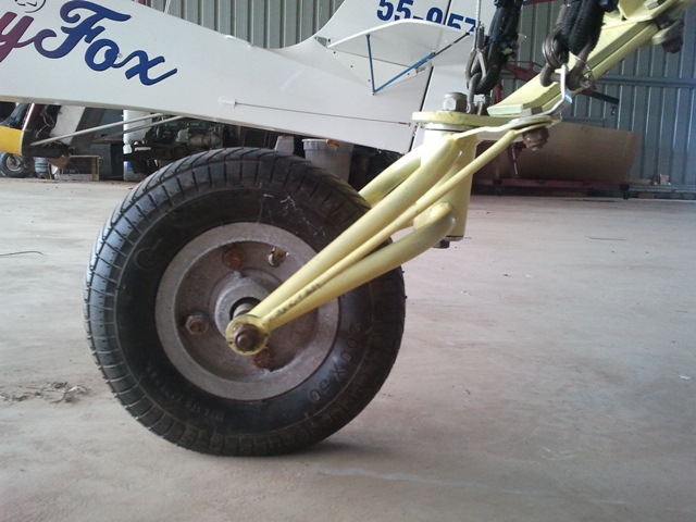

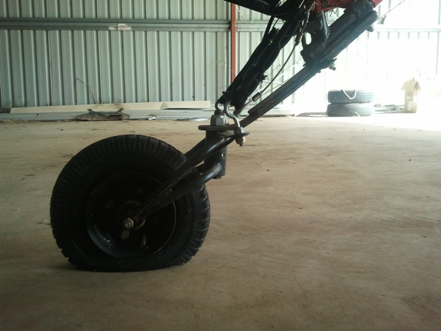

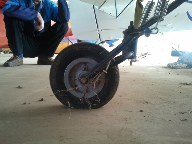

pudestcon Posted October 9, 2011 Author Posted October 9, 2011 Steve and I checked out the tail wheel today to see if we could nail the cause of the shimmy. The photos here show the tail wheel assemblies on all 3 Thrusters in the hangar - I must confess I don't see any difference to the castor angle on any of them (other minor differences are evident), with only mine having the shimmy. See what you think. The flat tyre on mine was a bit of a surprise this morning but no matter, soon have that sorted. I removed the tail wheel assembly from the aircraft and dismantled it to find one of the bearings completely shot. I didn't install the tail wheel so I'm not sure what condition the bearings were in at the start. I'll be replacing both bearings anyway this week. I'll also straighten the spring assembly as both leaves have a slight curve contributing to the sagging pivot point giving negative castor. I'll also make up some shims out of chrome moly steel to go under the lower spring clamp fixing the assembly to the tail structure, just in case I need them to give positive castor on the pivot point. Pud
