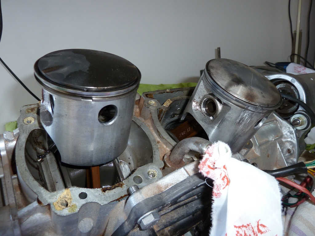

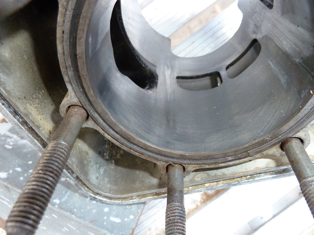

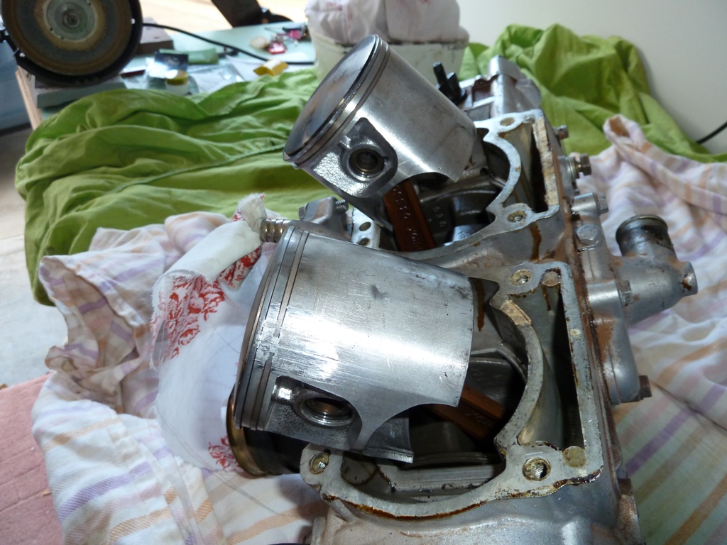

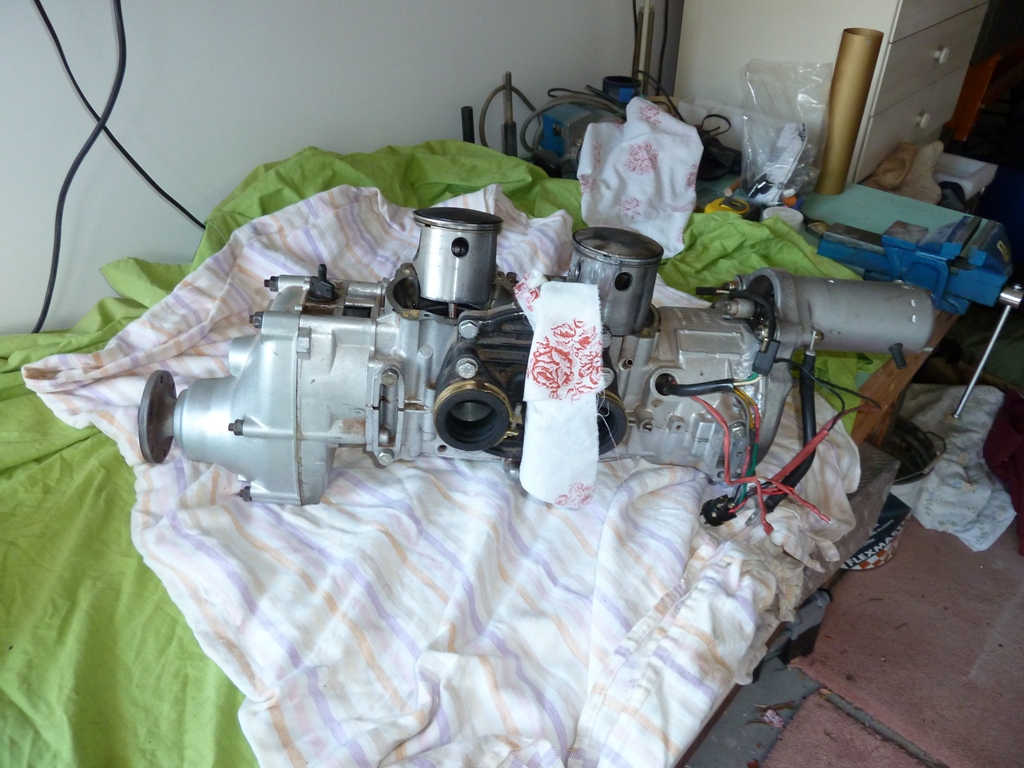

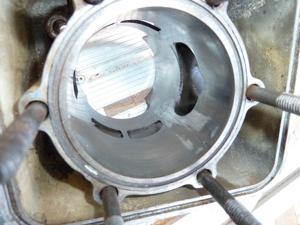

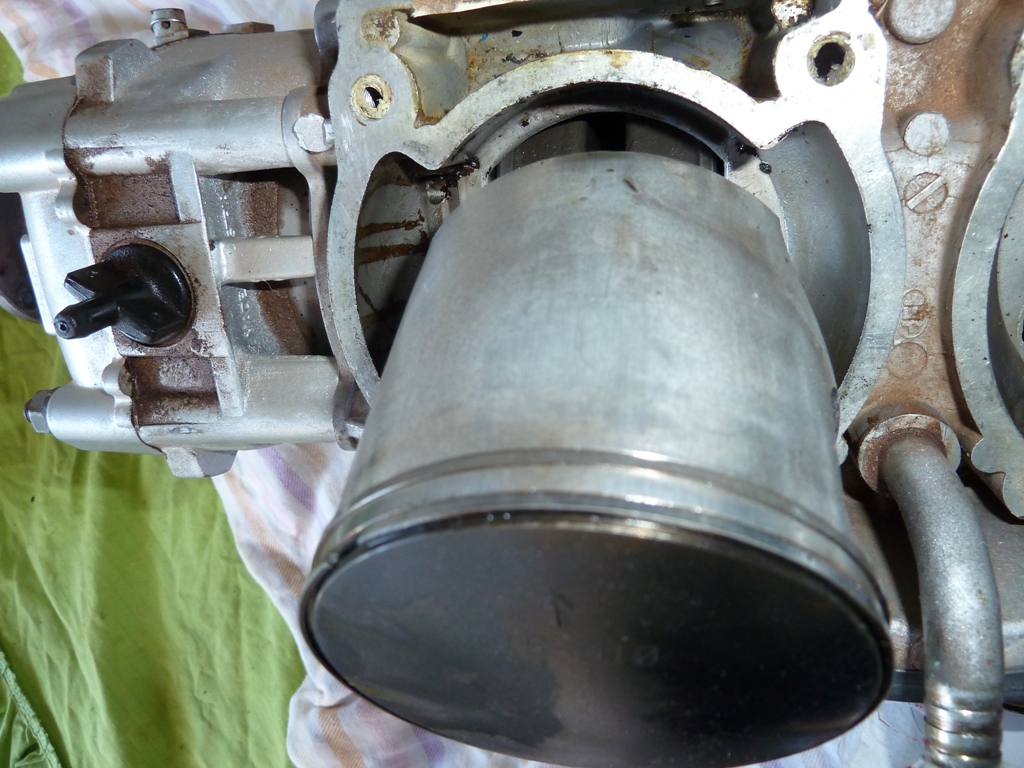

pudestcon Posted April 18, 2011 Author Share Posted April 18, 2011 Thanks for your thoughts Tomo, I took some photos of the damage for more mechanically minded people, like you and Maj, Tomo. Waddayareckon? This will give you perspective on the issue. ZFront piston - not that bad I hear you say.... Front barrel - note the discolouration just above the 2nd stud from the left Front barrel - slight scoring can be seen here The comparison shows plenty eh? Rear piston - some serious damage here. No wonder it wouldn't start! More damage to the rear piston And more!! New barrel required? Probably..... Yep, get the chequebook out, this is gonna hurt!! So what do you think - is this caused by a lack of fuel/lubrication? Pud Link to comment Share on other sites More sharing options...
fly_tornado Posted April 18, 2011 Share Posted April 18, 2011 My limitted knowledge of 2 strokes is the rings get pushed out around the locating pin from a build up from carbon, eventually the get pushed into the barrel wall and then into the port. The other scenario was it was running lean and the ring melted. The other thing you want to check is the cross hatching on the barrels, that's what holds the oil in place. Check your plugs to see how lean it was running http://www.theultralightplace.com/sparkplugs.htm Good luck with the rebuild Link to comment Share on other sites More sharing options...
pudestcon Posted April 18, 2011 Author Share Posted April 18, 2011 My limitted knowledge of 2 strokes is the rings get pushed out around the locating pin from a build up from carbon, eventually the get pushed into the barrel wall and then into the port. The other scenario was it was running lean and the ring melted. The other thing you want to check is the cross hatching on the barrels, that's what holds the oil in place. Check your plugs to see how lean it was running http://www.theultralightplace.com/sparkplugs.htmGood luck with the rebuild Thanks ft, That link is very good, so I've included it in my favourites. Pud Link to comment Share on other sites More sharing options...
