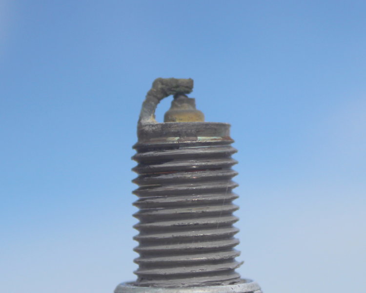

JG3 Posted February 4, 2018 Posted February 4, 2018 I once did a long trip on Avgas, and after 70 hrs got a bad mag check.... The first plug that I pulled the gap was completely closed by lead deposit. In all the others the cavity between the insulator and shell was full of deposit. 3
onetrack Posted February 4, 2018 Posted February 4, 2018 One of the more common features of plug fouling by lead is when the insulator on the centre electrode becomes coated with deposits, and this makes the spark "sidetrack" down the centre insulator to ground, without jumping the gap. It doesn't take much of a deposit coating on the insulator to do this, either. Iron deposits are the worst. The insulator can appear relatively clean, but the coating - often recognisable by pronounced discolouration - is a highly conductive coating. http://www.moto-parts.co.uk/sparkplugdiagnosis.pdf
