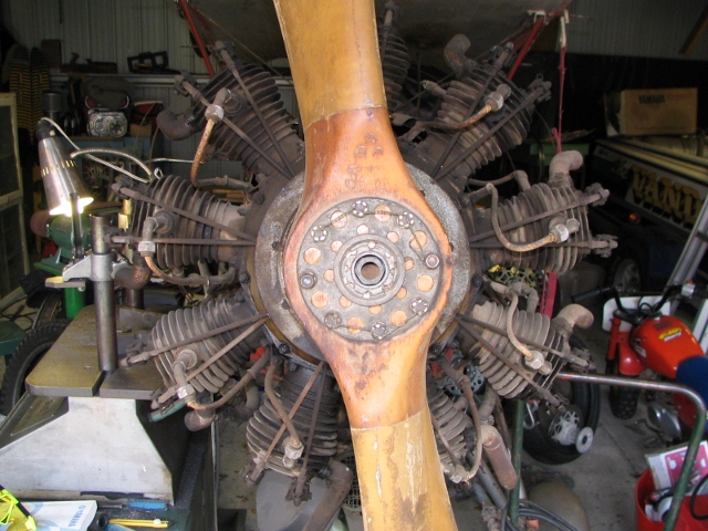

merc Posted May 26, 2011 Posted May 26, 2011 Quote The money at work is on its being a Pobjoy.OME no its a Salmson AD9. i saw it running in the early 60s when it was sold at auction, i purchased a Corben super ace from the same owner. the Corben was built at Narromine in 1938 and also powered by a Salmson , it is on loan to the narromine aviation museum who are restoring it for static display, they have just acquired a Salmson from the USA
facthunter Posted May 27, 2011 Posted May 27, 2011 OME the pobjoys are geared with a layshaft that puts the drive centre above the actual centre of the engine. They were very lightweight engines, especially for the time. Original engine in the Comper Swift. Would love to get hold of one. Nev

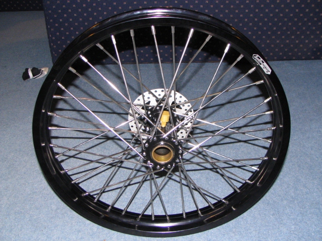

Bubbleboy Posted May 27, 2011 Author Posted May 27, 2011 I got the hubs back from the local engineers yesterday who turned a little from the inside of the Oilite bearings to fit the axle. Today I dropped them off at the powder coaters. He said they will be ready end of next week. Once I get these back I will visit the motorcycle shop and have it laced and trued and work out a time to visit his Piet. Photos then hopefully. Scotty

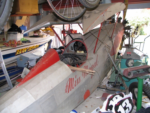

Bubbleboy Posted June 11, 2011 Author Posted June 11, 2011 Quote no its a Salmson AD9. i saw it running in the early 60s when it was sold at auction, i purchased a Corben super ace from the same owner. the Corben was built at Narromine in 1938 and also powered by a Salmson , it is on loan to the narromine aviation museum who are restoring it for static display, they have just acquired a Salmson from the USA Merc..you are right. It is the Salmson AD9 radial engine. I went and had a look at the Pietenpol Scout today with camera in hand. I also collected the first of my laced and trued rims and im very happy with the result!
old man emu Posted June 12, 2011 Posted June 12, 2011 Happy for you getting your wheels done. Jealous that you can get access to the P Scout. Have a go at those valve springs My boss reckons that spares for the engine would be like fonding hen's teeth in rocking horse poo. What is the name? Miss Mogal? What was the rego? OME
facthunter Posted June 12, 2011 Posted June 12, 2011 Think it's a Salmson (built in France) 9 NC. 154 Hp normally aspirated. Those valve springs are like half a "hairpin" valve spring which were used in the early Norton "International" OHC.motorcycles. Be lovely to get it running again. Nev
